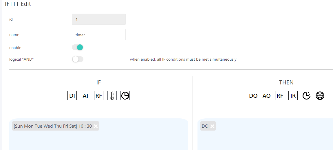

Hi everyone,
I am having trouble configuring my device.
I want to set the relay to turn on at a specific time and perform several functions.
Here is a screenshot, but unfortunately it is not working.
Please help and advice.
RE: Time control not working - admin - 03-22-2024
if you timer can't work, you can do a system-restore action. or hold on "S2" button >10 seconds, will be RESET for board.
here is sample i set the time zone firstly, then make a IFTTT timer work 10:30AM for TURN ON relay1. you can test as by photo step by step.
