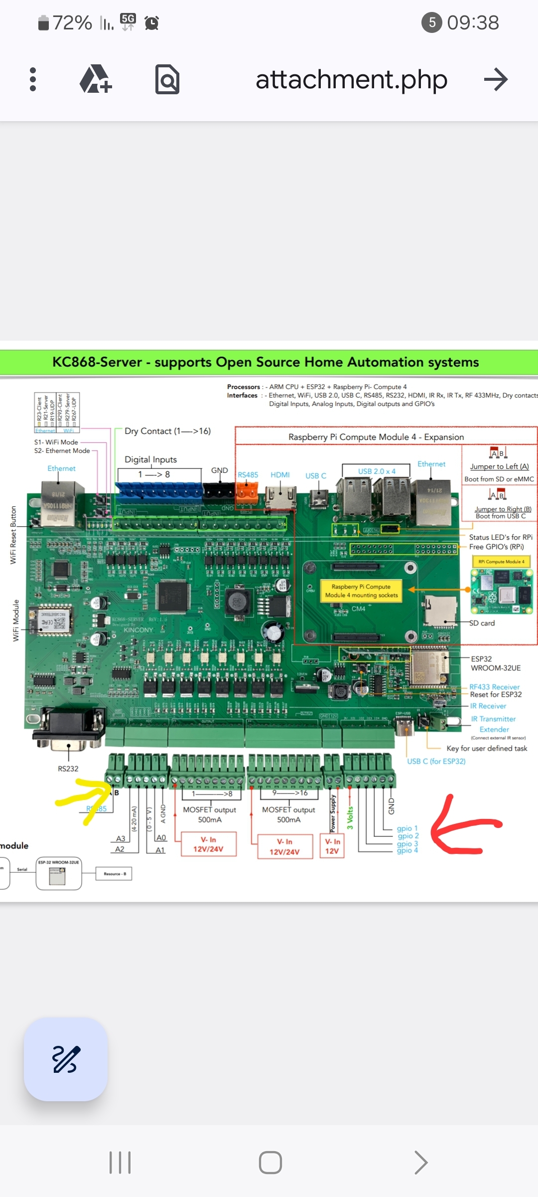

RE: how-to config ymal for work rs485 - itzek - 04-01-2024
Hi admin
It is modbus ,
According to a test I did, I need Modbus, so according to what you say, I need to use esp32. Do I need to connect the TX and RX on the server to the GPIO connections (according to the red arrow in the picture), if so, which of the 4 GPIOs do I connect to and what do I need to put in the yaml file
 tx_pin: GPIO13
 rx_pin: GPIO16
or I need to connect to A, B (according to the yellow arrow in the picture)
RE: how-to config ymal for work rs485 - admin - 04-01-2024
GPIO1,GPIO2,GPIO3,GPIO4 just GPIO with ESP32, it's not RS485 interface. if your device is RS485, you should connect with "ORANGE" terminal RS485 port.
