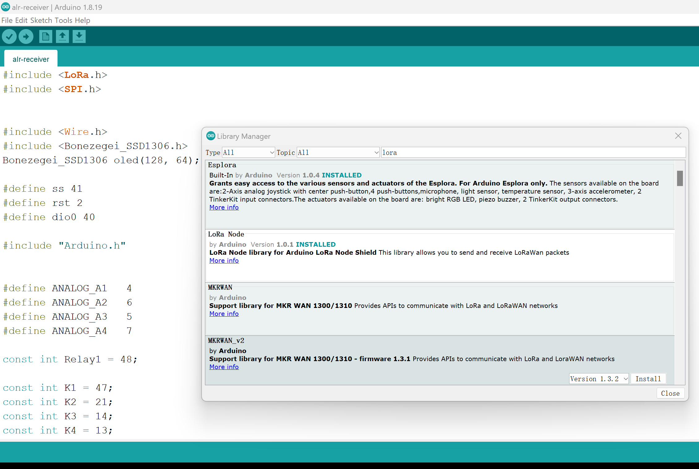

before use this code, need to install LoRa SX1278 arduino library firstly.
