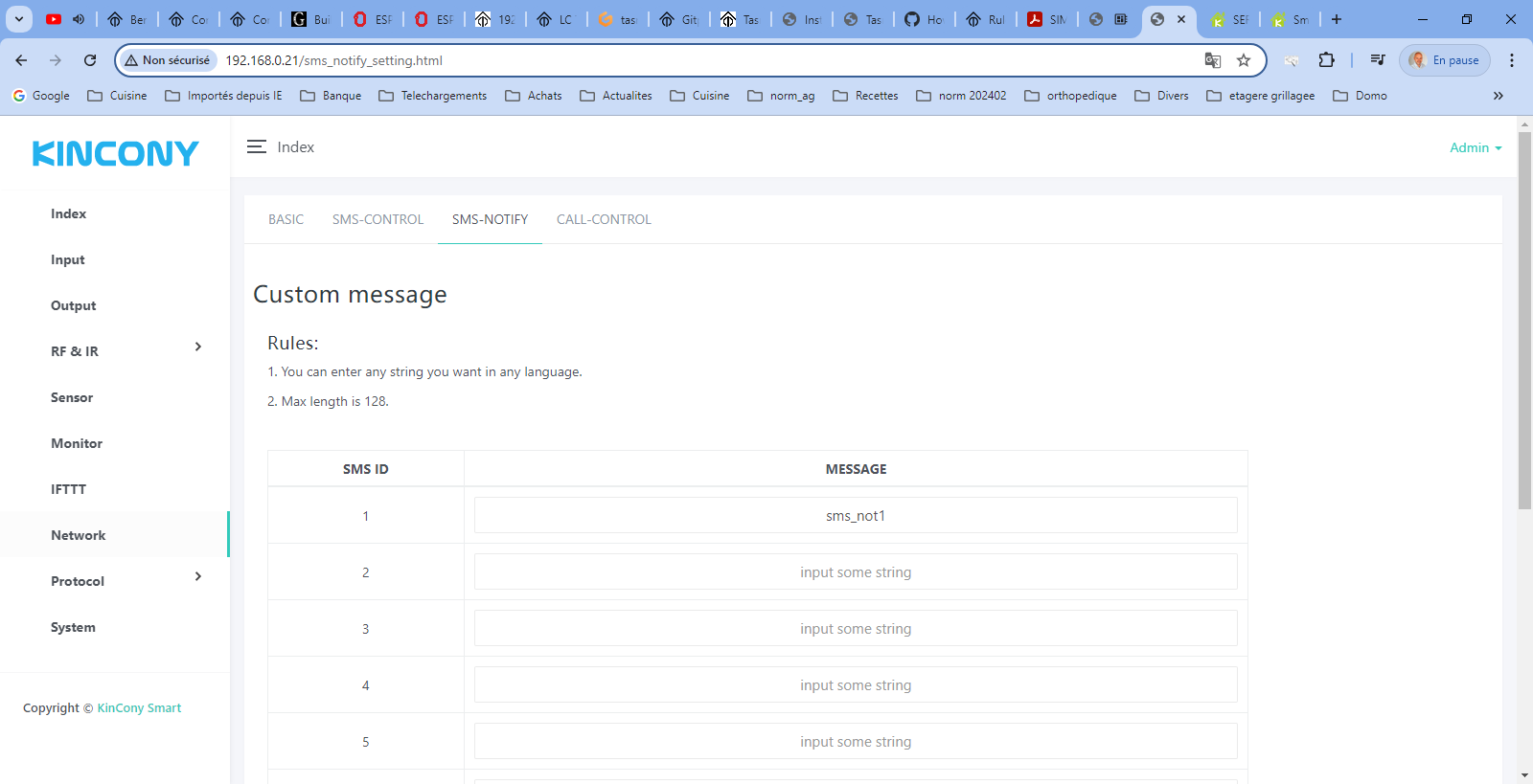

RE: kc868-A8S v2 not working with SIM7600E - t0urista - 08-29-2024
(08-27-2024, 10:04 PM)admin Wrote: upload your GSM setting screen in KCS.
please find here below the screenshots.
+324xxxxxxxxx is my mobile phone number (I hide the digits for privacy reasons ;-)
so I can do a test call to my mobile, but anything else fails (outgoing test SMS, incoming control SMS, outgoing notification SMS)

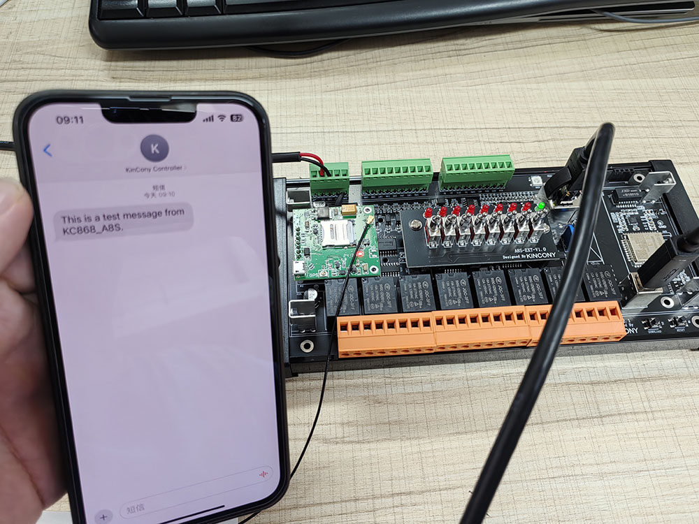

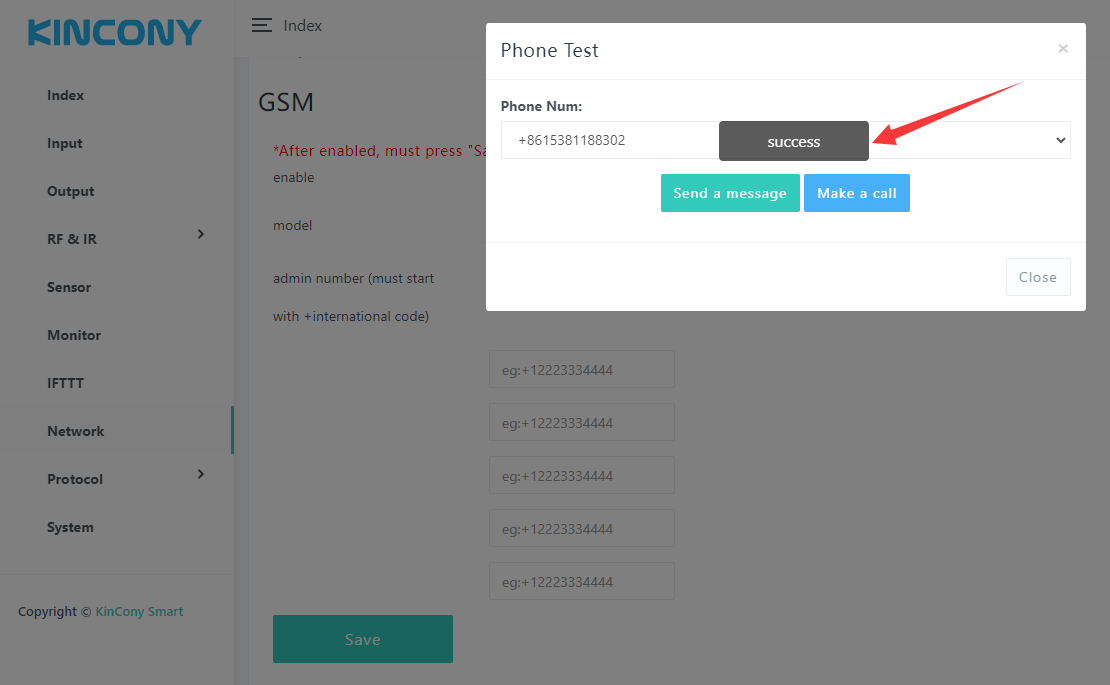

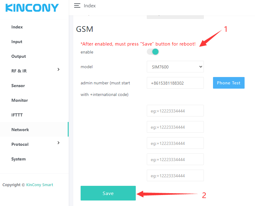

RE: kc868-A8S v2 not working with SIM7600E - admin - 09-06-2024
we have tested with new KCS firmware V2.2.4 here is download link:
https://www.kincony.com/forum/showthread.php?tid=6600
important: make sure when you enabled GSM, you MUST need click "SAVE" button for reboot. Then you can use TEST with SMS or CALL.
