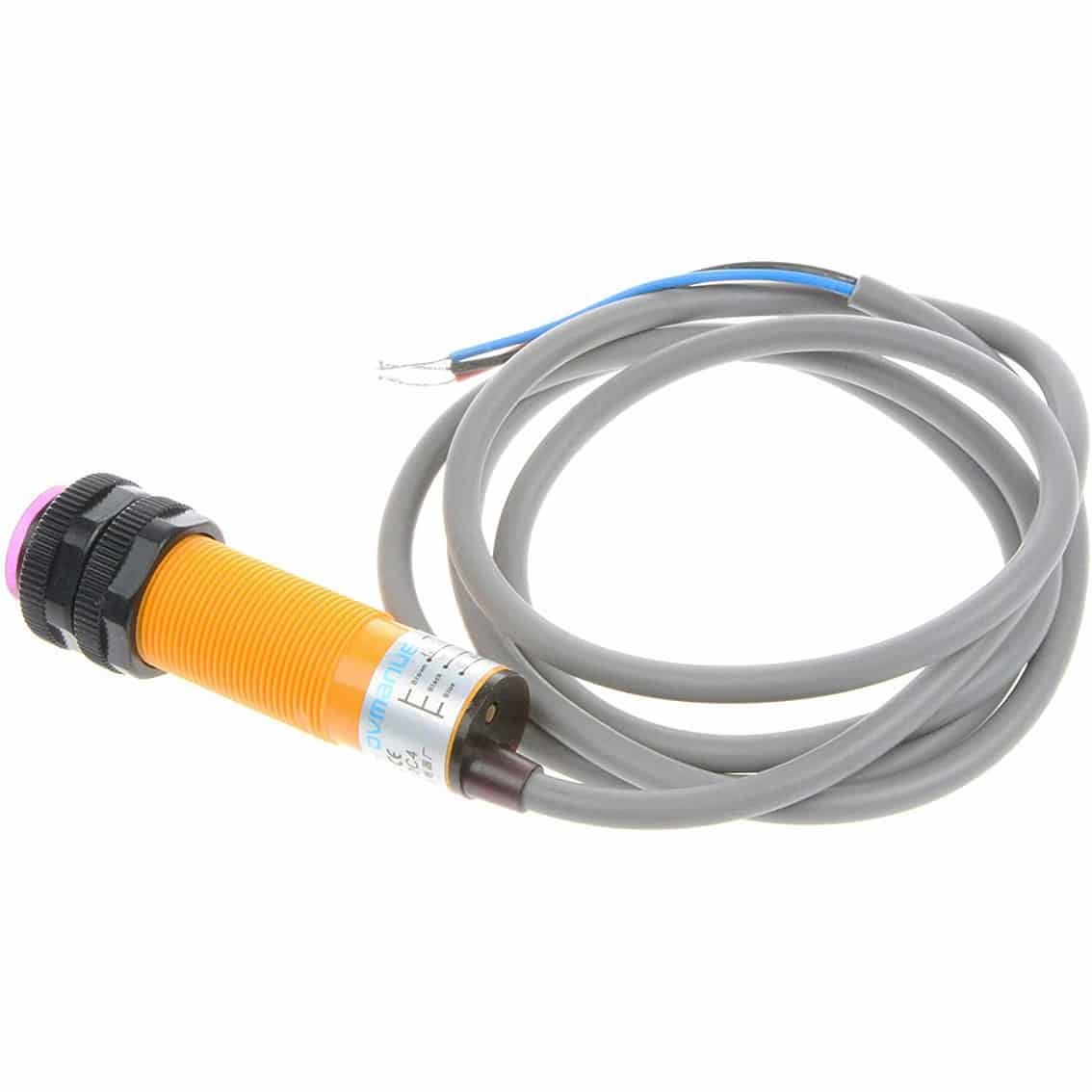

I would like to use IR Photoelectric Switch such as :  PNP, Normally Open sensor. E3F-DS30P1
Ideally, I would use the 12v from the A6 board to power the IR switch, I'm only concerned about the output of the switch...
Can I connect it safely to one of the Digital inputs or Analog inputs?
The E3D-DS30P1 will output the exact same voltage as it get's on it's the vcc leg when it detects an object.
thanks!

RE: using 5v-12v as input sensor - amararsa24s - 09-09-2024
i just want to double check before i burn the board Smile
Are you sure it's a dry contact? the  E3F-DS30P1 is a PNP that have just 3 wires and the output voltage is the same as the input. (sorry, i'm not electrician)
meaning that if the input is 12v, the output will also be 12v.
i have several similar devices working in different voltages can you confirm the following?
1. will 5V entry on digital input port is OK?
2. will 12V entry on digital input port is OK?
3. will 24V entry on digital input port is OK?
(09-08-2024, 11:26 AM)admin Wrote: it's dry contact signal of E3F-DS30P1. so just connect to KC868-A6 board's digital input port.
this PNP - Normaly open sensor : the black will output positive voltage signal when object is detected.
the output voltage is the same as the input 6-36v
