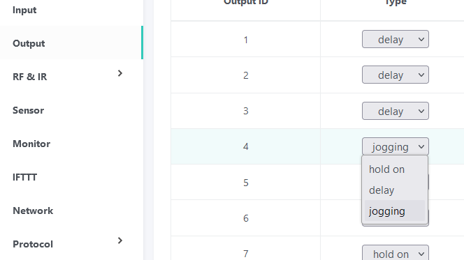

How does output work in "jogging" mode?
I don't see any diffrence with "hold on" mode.

RE: Jogging - remiasz - 09-09-2024
Board Model KC868_A16
Software Version v2.2.4
Build Date Jun 18 2024 13:52:03

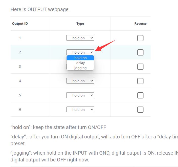

RE: Jogging - admin - 09-09-2024
KCS v2 no "jogging" option. because you can create IFTTT command for "jogging" function. let digital input button pressed THEN relay ON, when released THEN relay OFF.
RE: Jogging - remiasz - 09-10-2024
So the jogging option in the output settings was left by mistake?
RE: Jogging - admin - 09-10-2024
you are using KCS v1 firmware.
the KCS v2 firmware no this option, here is KCS v2 online guide: https://www.kincony.com/esp32-kcsv2-firmware.html
RE: Jogging - remiasz - 09-11-2024
I use firmware 2.2.4
This is just from your online guide
RE: Jogging - admin - 09-11-2024
jogging option is "invalid" in KCS v2 version, just create IFTTT for "jogging" .
