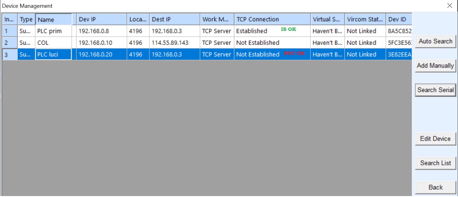

hi, this morning I found H32L disconnected. the network card is turned off and has no green LEDs on. ESP32 tuya module also fails to connect. I tried changing the cable but nothing.
from the input keys the plc works correctly. I attach a screenshot, where you can see that it is not online. what could have happened?
Thank you

RE: H32L - faulty network card - athxp - 09-17-2024
I solved it: the module in the photo was broken. I still had an old H16 and I got the spare part from there.
