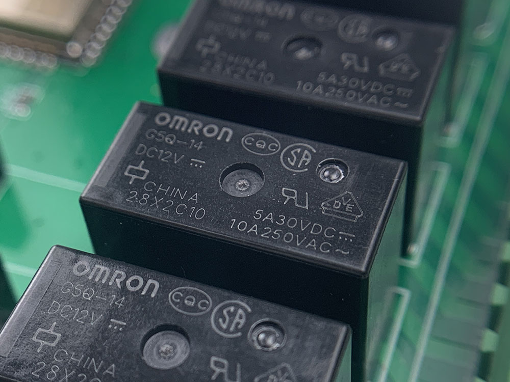

I'm looking to use the KC868-A16S relay board for lighting here in the US, and for that, the outputs would pass through 120v and up to 10A.
What wiring gauge do these terminals accept?
What is the model of the OMRON relay?
Is there any certification for this, like UL or similar?
TY.
RE: AWG/gauge of output, and certification - admin - 09-28-2024
1. 10A current at 120V: For shorter runs (generally less than 50 feet or 15 meters), 14 AWG copper wire is commonly used.
2. here is photo of KC868-A16S' OMRON relay, model: G5Q-14
3. not have UL, but have CE, see here: https://www.kincony.com/cerfificate
