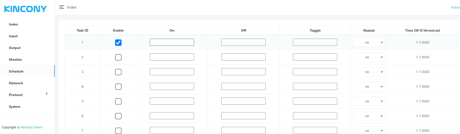

RE: A128 and B32Pro - kkabuu - 10-30-2024
How do I write the "INPUT1=ON, OUTPUT1=ON; INPUT1=OFF, OUTPUT1=OFF;" command in IFTTT in below screen capture?
Thank you
RE: A128 and B32Pro - admin - 10-30-2024
we have two way for this function:
1. config by KCS webpage, using KCS v1 firmware.
2. configy by ESPHome, using ESPHome firmware.
if use by KCS, just set as this photo at "INPUT" webpage:
[Image: input-bind-output.png]
here is details, suggest you see this online guide firstly: https://www.kincony.com/kcs-firmware-esp32-board.html
