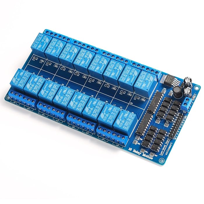

Instead of trying to connect a 96-volt power supply to each of the 8-channel outputs on the KC868-A16 board, I decided to order a 12V 16-channel relay module for arduino (An example of this board is seen here: https://www.desertcart.ae/products/1170701-sainsmart-16-channel-12v-relay-module-board-for-arduino-dsp-avr-pic-arm).
If I can get this setup working the way I'm hoping, each of the devices I connect to the relay module can be powered by its own separate 12V 3A power supply.
How can I use this relay module with the KC868-A16, such that the A16 outputs can control each of the respective relay switches?  Do I just need to connect each of the 16 outputs on the A16 to the 1-16 input pins on the relay module? And will the relay module need its own power supply, or will the A16 board be able to supply power to it somehow?
RE: How can I power multiple devices simultaneously using KC868-A16? - ingersoj - 12-09-2024
Instead of connecting a 96-volt power supply to each of the 8-channel outputs on the KC868-A16 board, I decided to order a 12V 16-channel relay module for arduino (An example of this board is seen in the attached picture).
RE: How can I power multiple devices simultaneously using KC868-A16? - admin - 12-09-2024
KC868-A16 mosfet output 12v for extend relay. just use 12V 3A power supply for KC868-A16, not need add extend power supply.
