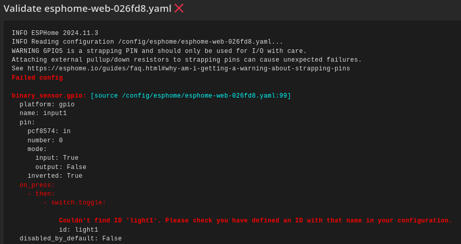

In KC-868 A8 in EspHome I have problems setting up the switch component.
I want that when I press digital Input#1 then relay #1 Toggles.
PCF8574 I/O Expander uses I2C Bus to set IDs, probably that is why the YAML validator don't recognizes the ID of light1? I don't know.
I know I can link the inputs and the relays in HomeAssistant, but I want the logic to be coded in the board so It still works if Internet brokes.
I also know that KCS firmware allows that requirement, but I am looking for an EspHome solution.
Thank you

Yaml Validator Output:
RE: Esphome invalid config KC-868 A8 - admin - 12-09-2024
you should add "id" option, here is sample code for KC868-A8S, but the INPUT trigger OUTPUT as same way.

Thank you,
I just discovered it and came here to publish the answer, in case someone finds it usefull this worked for me:
  - platform: gpio
    pin:
      pcf8574: out
      number: 0
      mode: OUTPUT
      inverted: true
binary_sensor:
  - platform: gpio
    pin:
      pcf8574: in
      number: 0
      mode: INPUT
      inverted: true
    on_click:
      min_length: 50ms
      max_length: 350ms
      then:
        - lambda: |-
            id(relay1).toggle();
