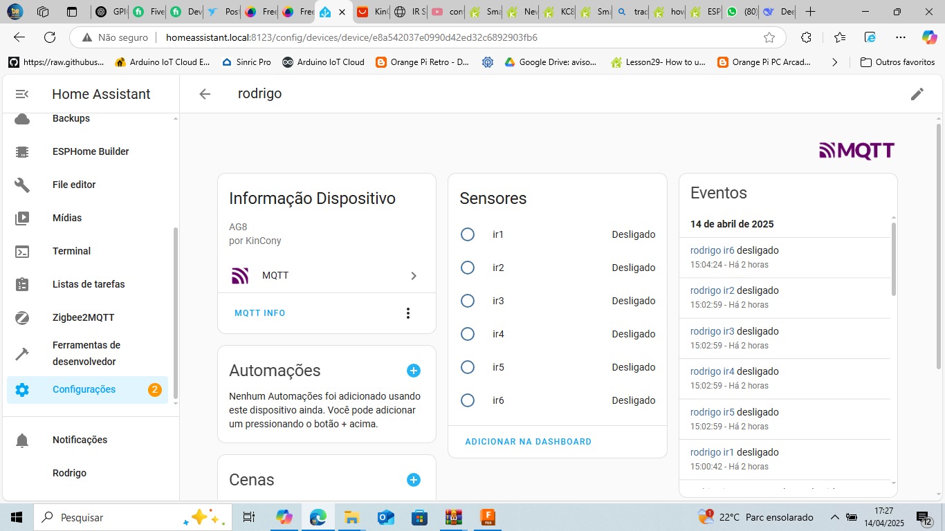

RE: firmware problems - Rodrigo - 04-17-2025
when I use the KCS firmware, and add it to the home assistant, it does not appear the buttons to send the code, just like in the photo, I have already added the go codes there in the ks, but they do not appear in the home assistant
RE: firmware problems - admin - 04-17-2025
in KCS monitor webpage, when you preseed one IR button, whether ico will turn GREEN color?
