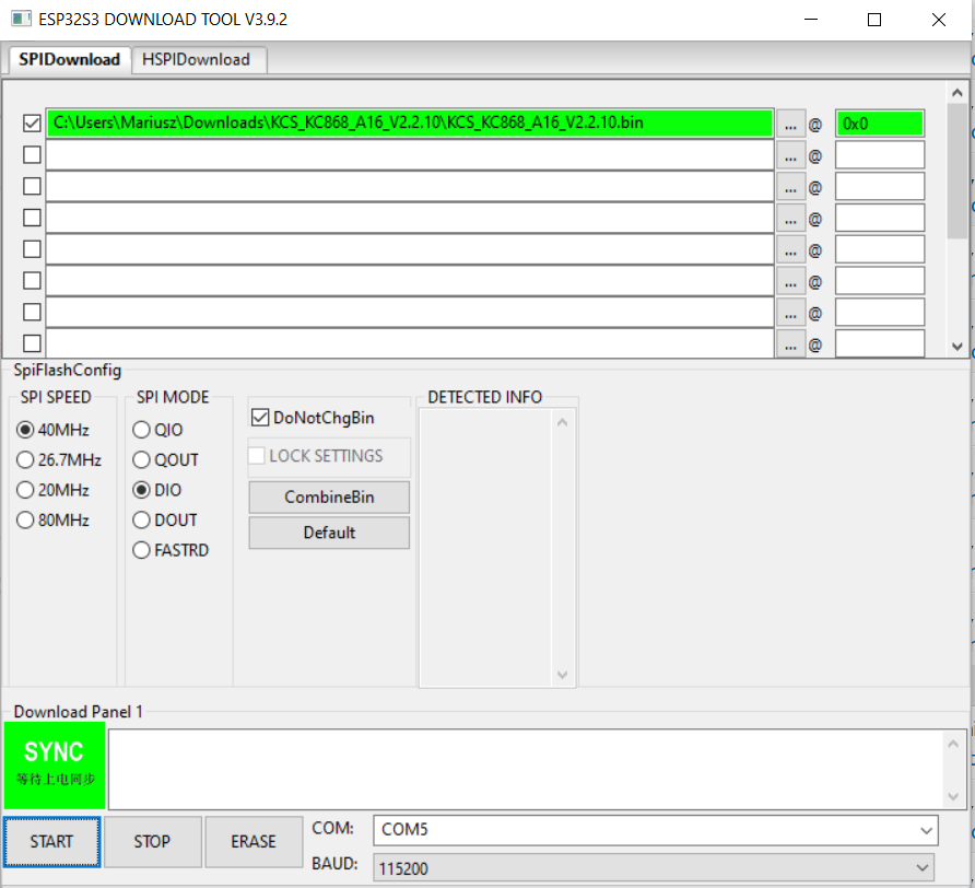

I'm asking for help because my inputs don't work.
I check by shorting the input to GND - as in the instructions.
Do I need to configure it? I tried various configurations but without any positive effect (picture).

RE: Inputs don't works - osis - 01-14-2025
(01-13-2025, 11:15 PM)admin Wrote: because you are download OLD firmware, the new KCS v2 firmware at here: https://www.kincony.com/forum/showthread.php?tid=7283
please see the KCS v2 online guide clearly.
when trying to change the firmware, the status is SYNC all the time
RE: Inputs don't works - admin - 01-14-2025
when download firmware, remove the RF433M receiver from PCB.
