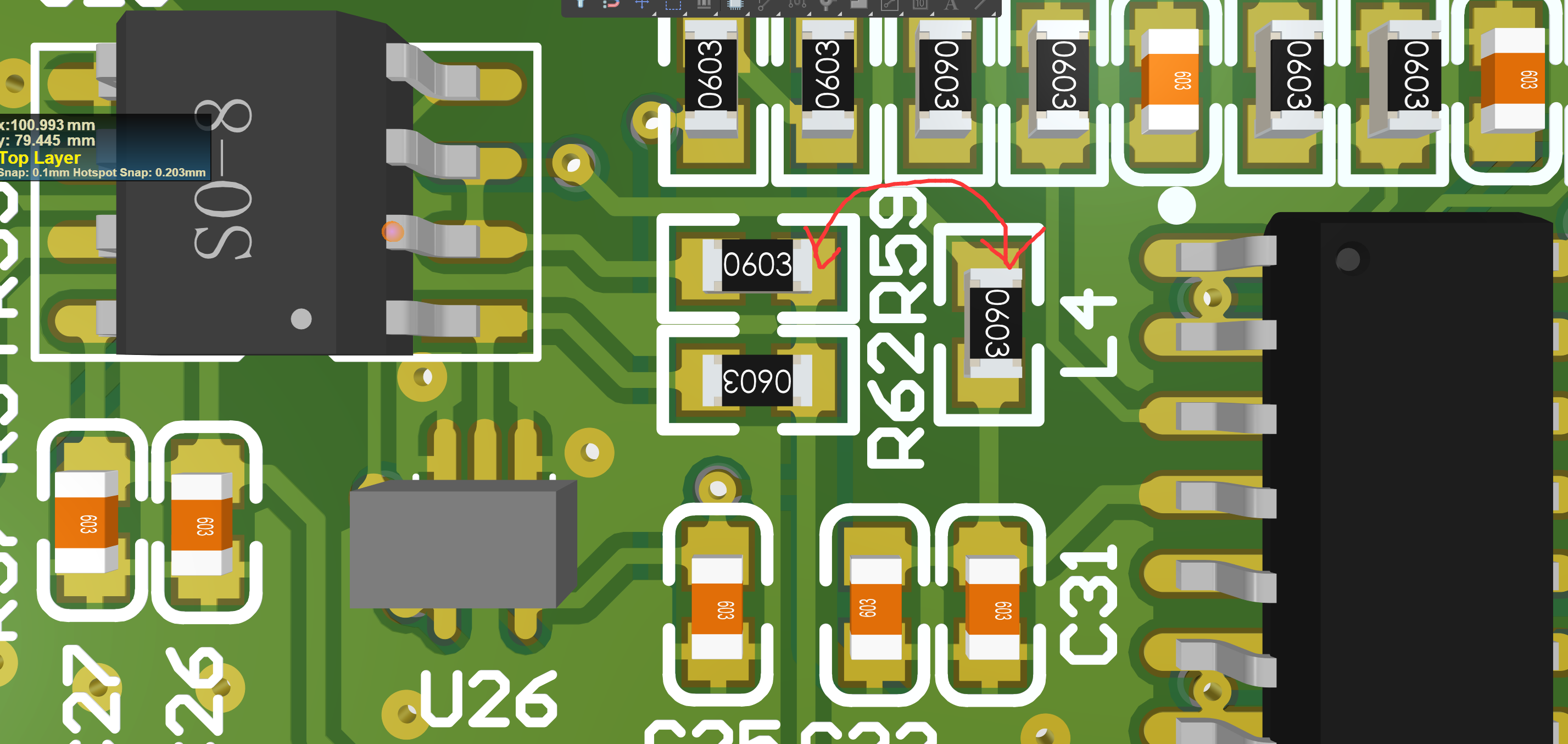

yes, there is a bug in PCB, we will fix it in next PCB version. if you want use POE with digital input, need add a jump wire on PCB. if you can weld and jump wire. i can tell you how to do.

1: R17,R18,R19,R20,R21,R22,R23,R24  are 4.7K, need replace with 1K
2: make a wire jump as photo RED jump line.

I think I can make a wire jumper like you initially said, but I'm not capable of replacing resistors. If the boards have a problem I think you should get the bad ones and send me new ones. I've 20 of them.

i think you can make the jump wire firstly. if work well , not need replace the resistance.
