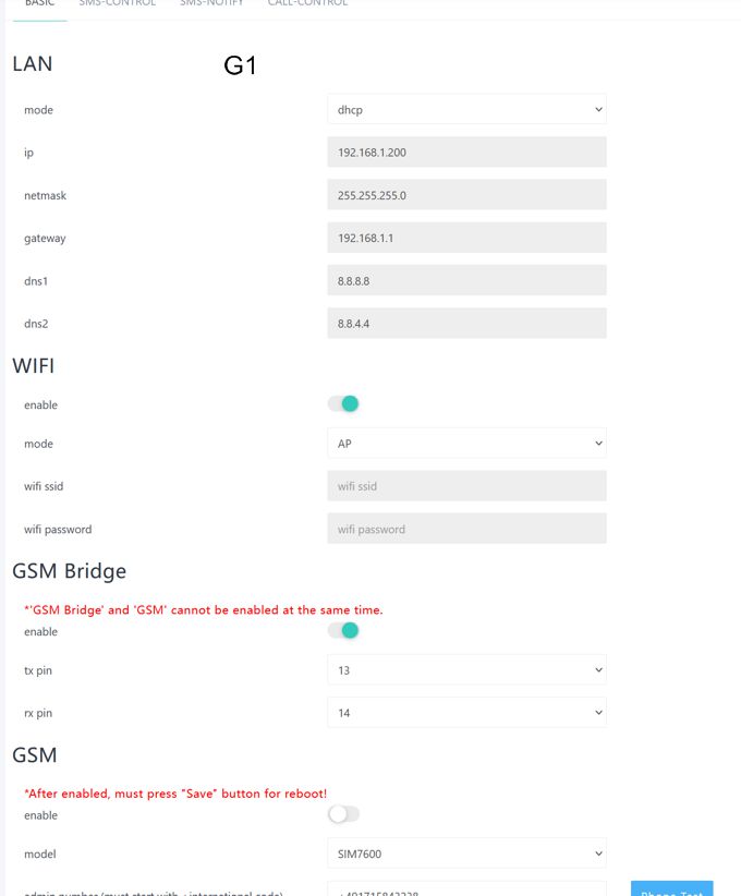

G1 connection problem to KC868-A16v3 - classiccars - 03-26-2025
I get no Test SMS going out via A16v3
Test SMS with standalone G1 worked, so SIM ist OK.
Connected G1 GPIO 13 (TX) with A16v3 GPIO 40 (RX)
Connected G1 GPIO 14 (RX) with A16v3 GPIO 39 (TX)
Network/GSM is enabled on A16v3
GSM Bridge is enabled on G1
What might be wrong?
RE: G1 connection problem to KC868-A16v3 - admin - 03-26-2025
take setting screen photo on G1 and KC868-A16v3.
make sure G1 and A16v3 all have downloaded KCS v3 firmware.
