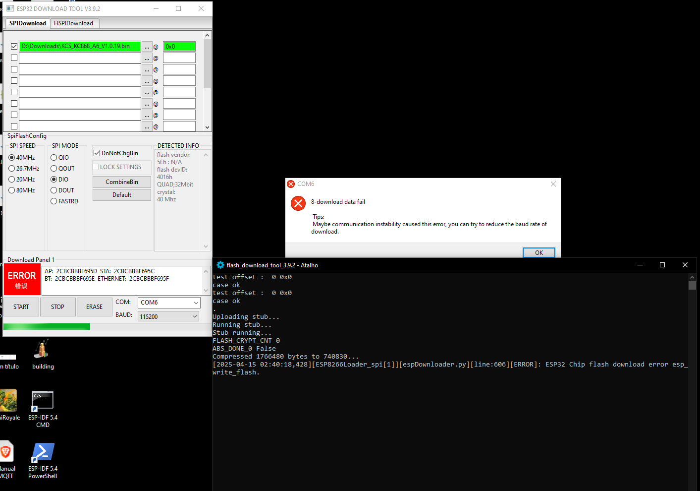

Hi everyone, I'm having trouble uploading data to my KinCony KC868-A6 v1.3SP board and would really appreciate some help.
This morning I got home and, to my disappointment, the board wasn’t working. I finally had time to try uploading my firmware again, but it’s not working.
  • The board’s LED is on as usual.
  • The USB connection is recognized by my computer.
  • However, in the SPDownload tool, the board info doesn’t appear — it seems like it’s not being detected properly.
  • I’ve tested four different USB cables (all confirmed to work for data transfer on my Samsung smartphone).
  • I don’t have any sensors connected to the board right now.
  • There were no power surges or electrical issues today, so I doubt the ESP32 is fried.
Has anyone experienced something similar or have any ideas on what I can try to fix this?
Thanks in advance!

With erase the and flash, the board started to work again.  but i cant update any config on web server.
i cant flash with ESP32 DOWNLOAD TOOL.
the error occours.
