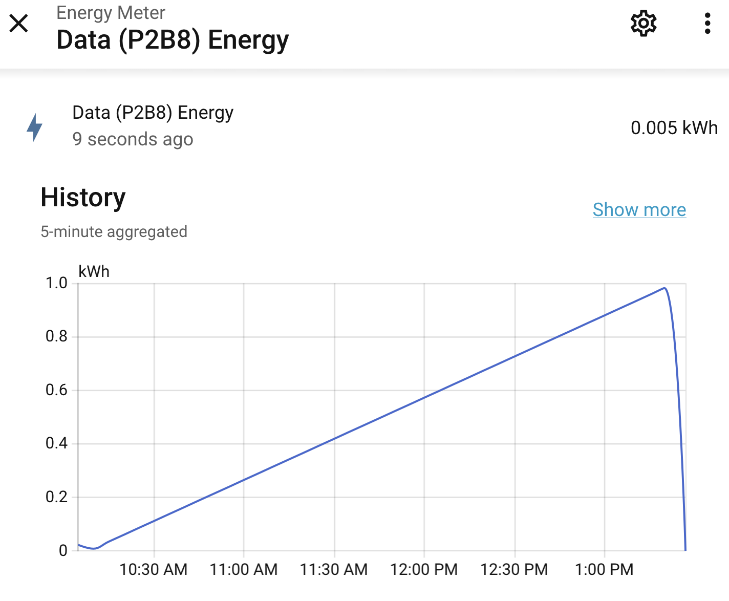

Unfortunately, kWh data is still being reset on power cycle:
Here I let me server cabinet run for a while, accumulate some stats, and then I power cycled the device. You can see that the next reported stat is 0.01kwh.
(The only reason it did not report "0.0kwh" is because I added a bit of YAML to prevent that.)

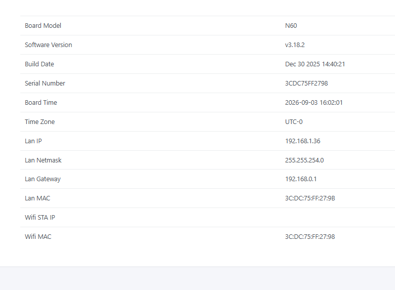

Installed ARM firmware from here (https://www.kincony.com/forum/showthread.php?tid=9172)
Installed KCS from here (https://www.kincony.com/forum/showthread.php?tid=8864)
Version page:

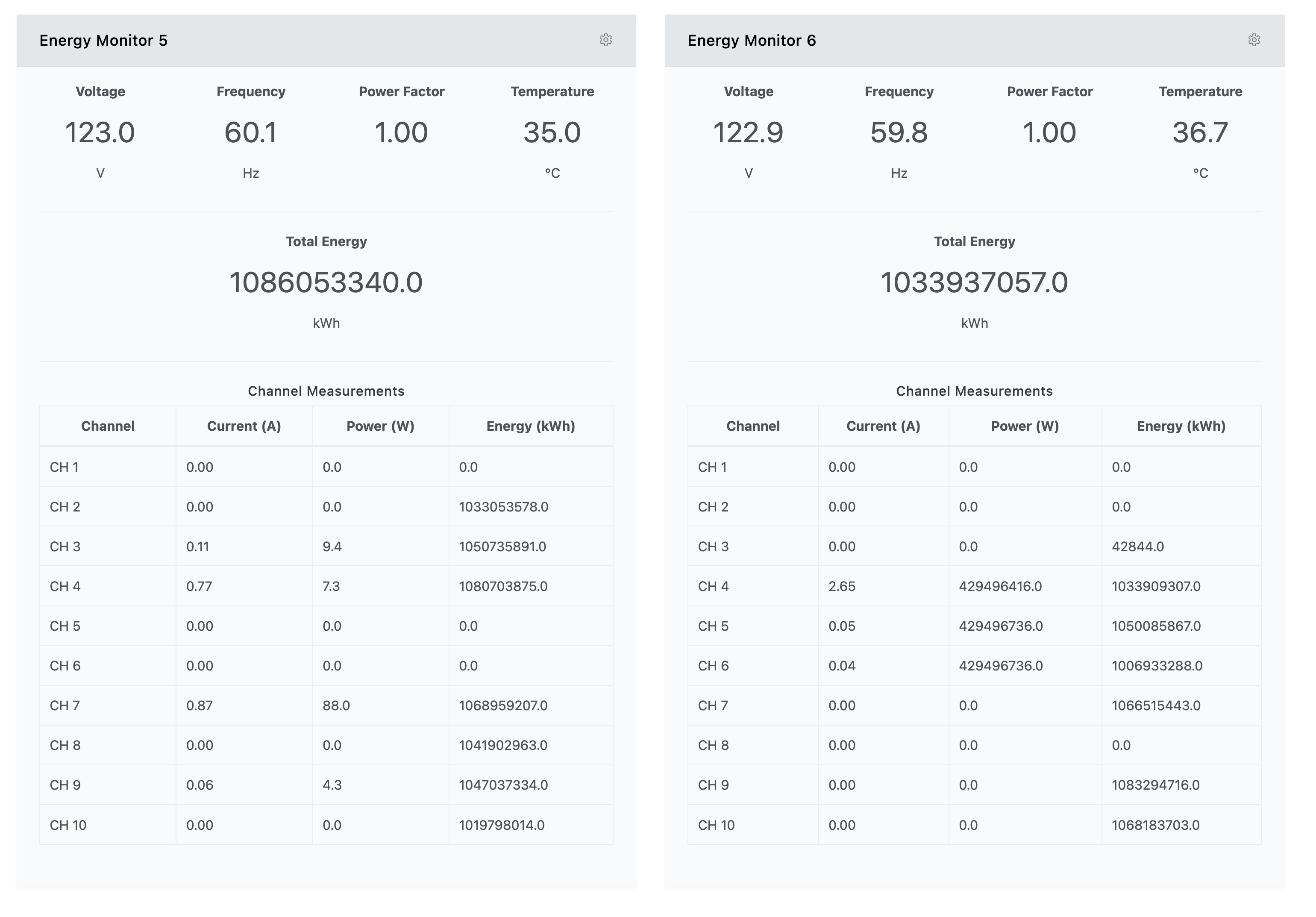

Monitor page (bank 5 and 6):
I attempted to use the "clear" buttons from within the KCS software to reset the stored kWh values, they did not reset anything. Additionally, I attempted a "Factory Reset" button click, also did not reset any saved kWh values. (In both cases, the button press was then followed by waiting for the unit to reboot itself.)
I've gone down this rabbit hole because I wanted to have a fresh starting point for testing the CT's. In addition to one of the CT's not restoring previous kWh values that started this thread, I've also noticed that CT 59 and 60 (bank 6, ch 9&10) have registered kWh's...despite the fact that I don't have anything plugged into those ct pins!
