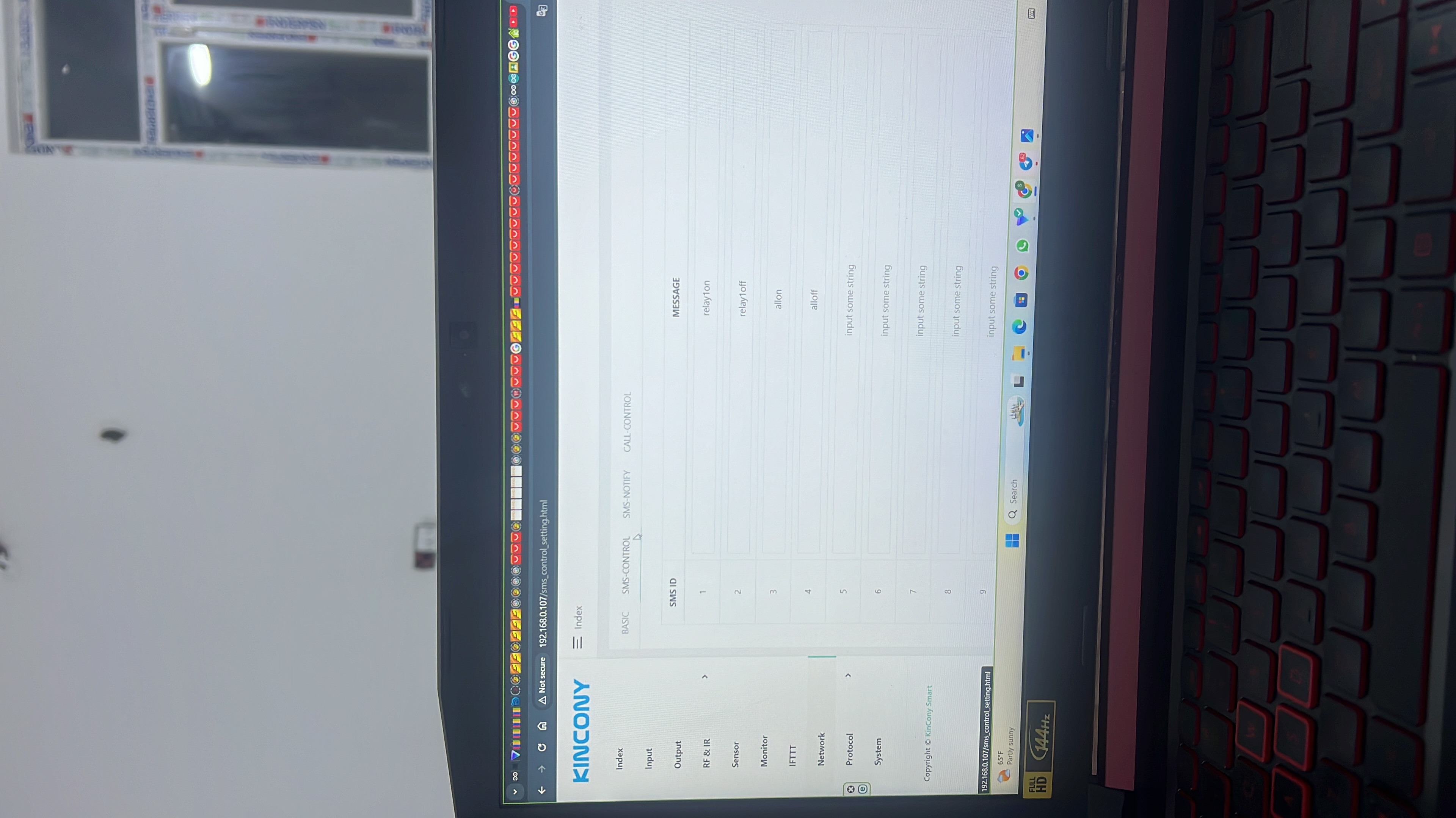

hello
When sending a message from the phone, the device does not respond,
I can only send messages from Kc868-A8S to phone.
if you have downloaded KCS firmware, just create IFTTT command, when received SMS THEN relay output ON/OFF/Toggle.
(12-01-2023, 12:21 AM)admin Wrote: if you have downloaded KCS firmware, just create IFTTT command, when received SMS THEN relay output ON/OFF/Toggle.
have downloaded KCS firmware: kCS_KC868_A8S_V2.1.9
Icreate IFTTT command but not relay output ON when received SMS
you should create IFTTT command, when "SMS"1 THEN RELAY1 ON.
you have not edit the IFTTT command. please see online guide how to create IFTTT by SMS: https://www.kincony.com/esp32-kcsv2-firmware.html
