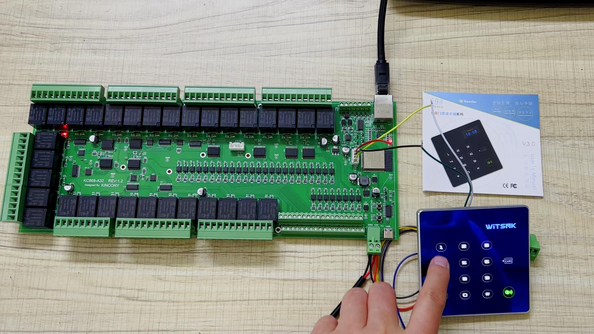

access control panel by wiegand protocol configure yaml for ESPhome
here is demo config file for access control panel. control relay2 or relay3 by different finger or IC card or INPUT NUMBER by touch panel.
.txt   HA_A32_finger_wiegand26_tag.txt (Size: 12.93 KB / Downloads: 1,003)

here is video tour about wiegand work with ESPHome: https://youtu.be/v-Vs4NbJy5k
