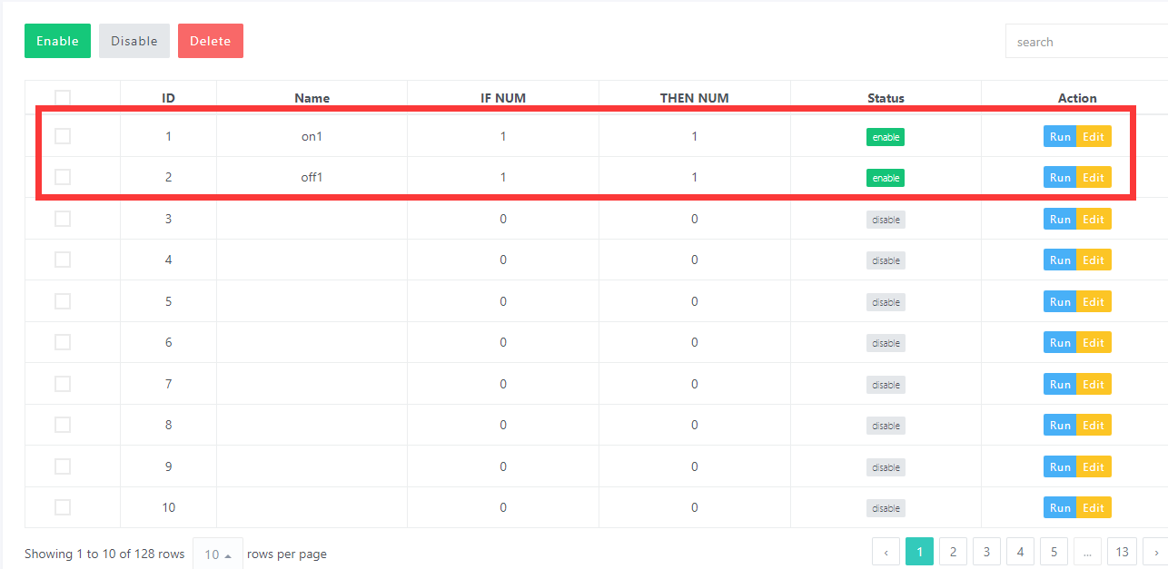

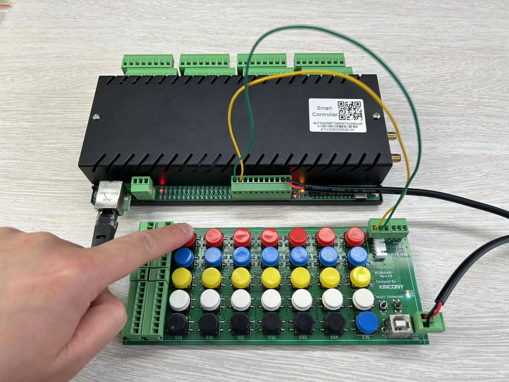

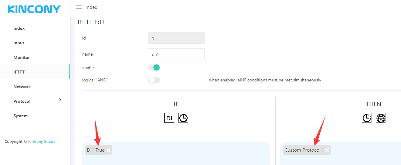

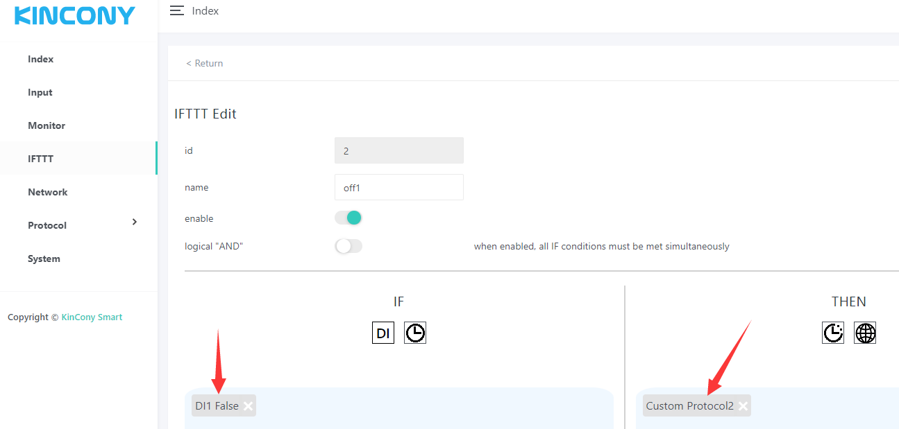

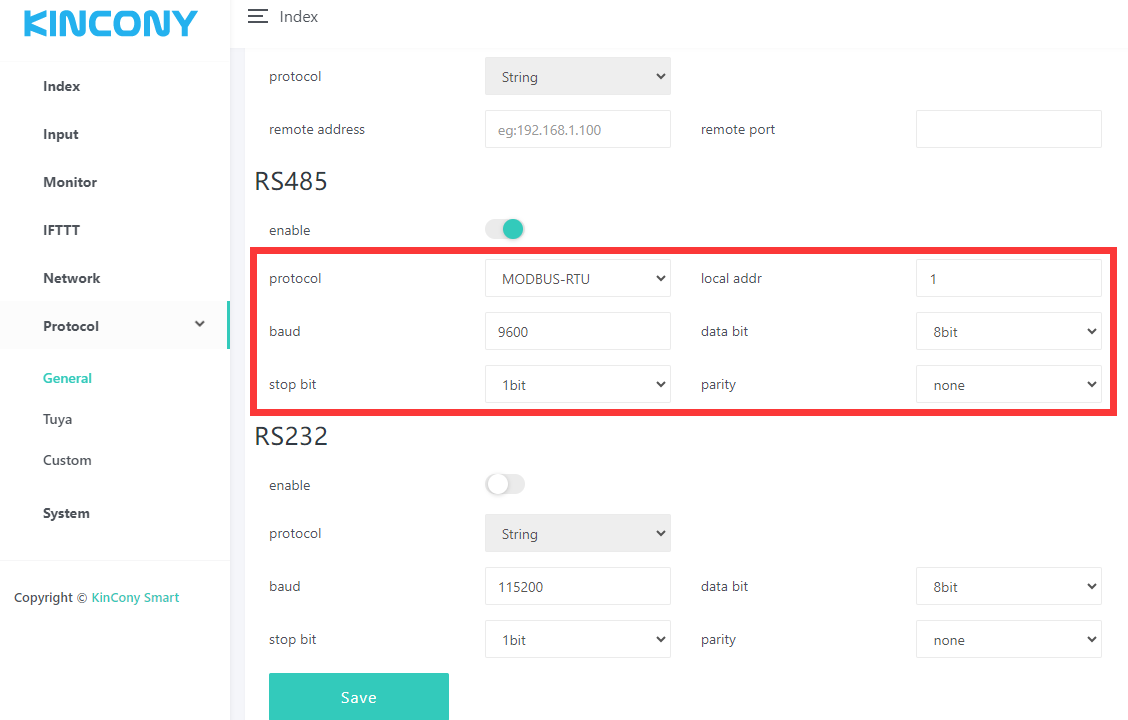

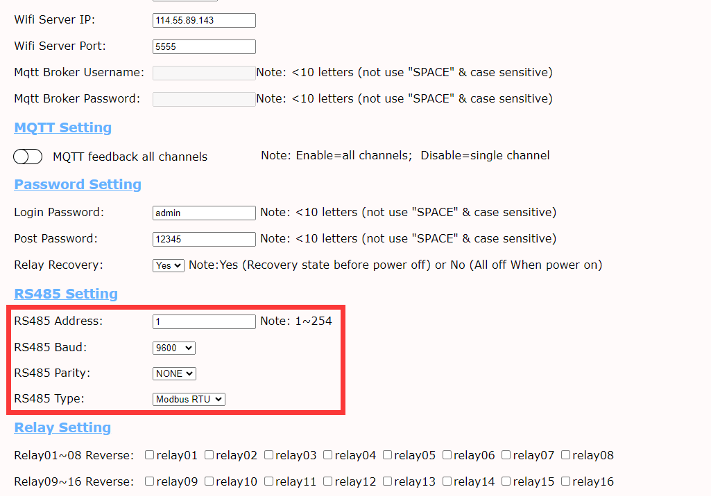

how to set KC868-H32B Pro relay inching mode with push buttons
for example:

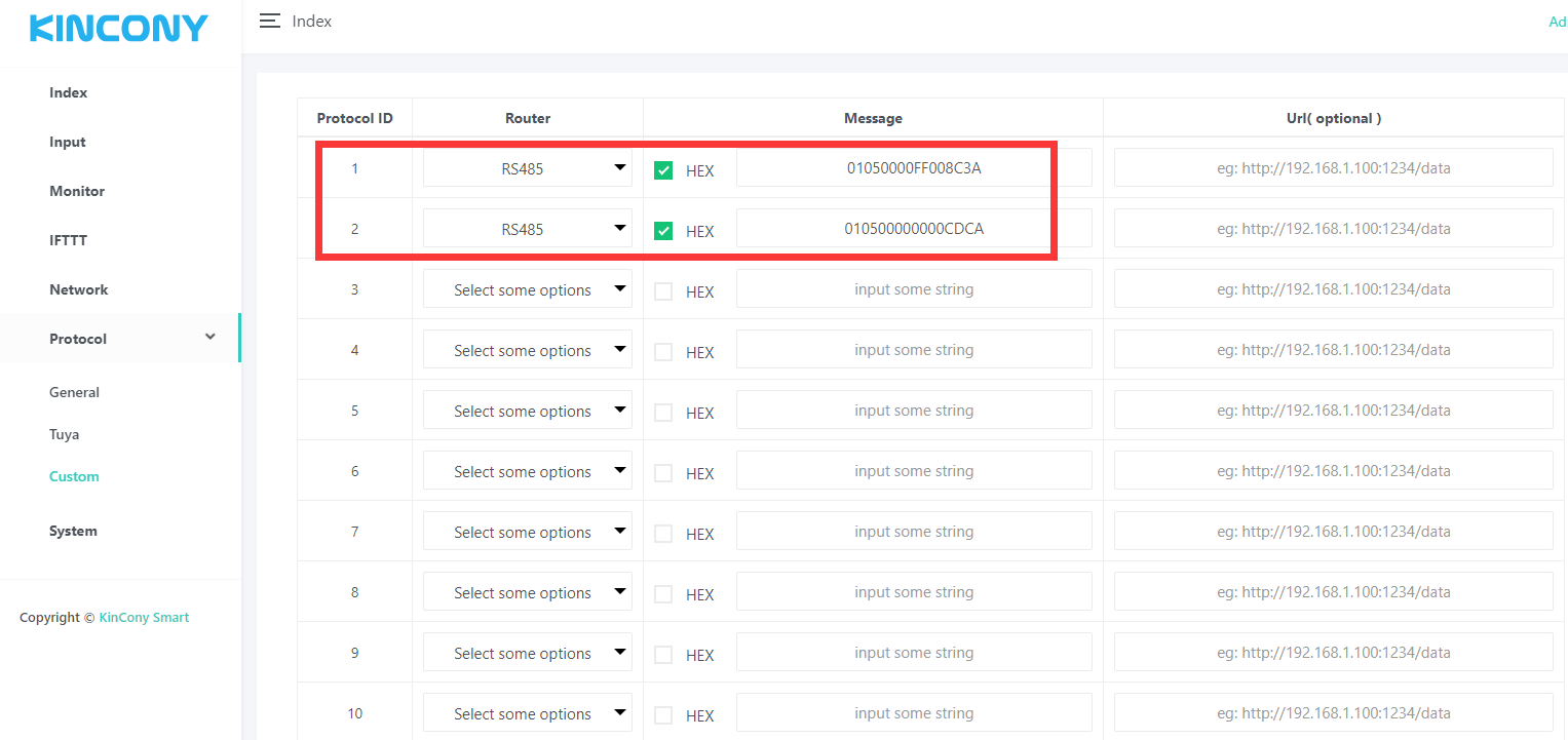

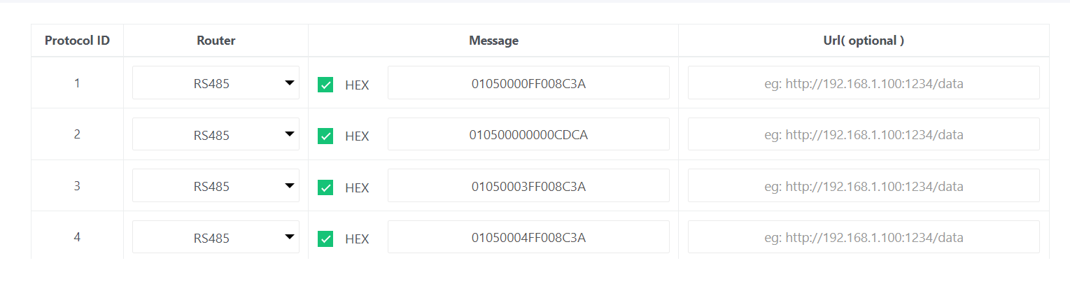

H32B Pro relay1 ON RS485 modbus command is: 01050000FF008C3A
H32B Pro relay1 OFF RS485 modbus command is: 010500000000CDCA
so you can create all custom RS485 protocol command for any buttons.

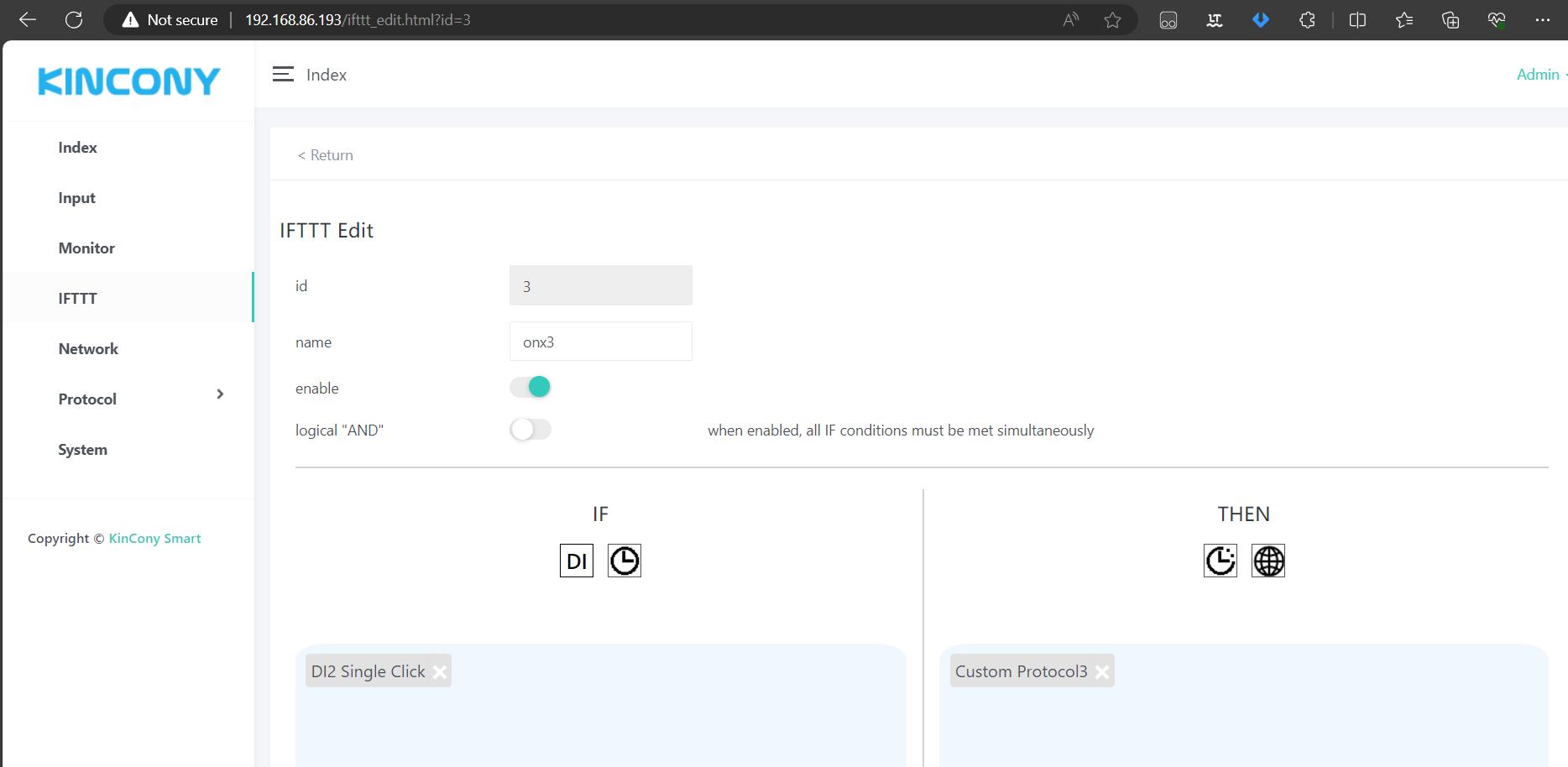

hello
i configure more custom mesage and not run:
mesage -> 01050003FF008C3A
not turn on relay 3

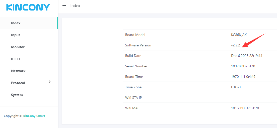

If you are not familiar with modbus, we suggest you download v1.0.7 firmware to your KC868-AK, because every modbus command, last two bytes is CRC code, it's not fixed. i suggest you download this firmware:
.zip   kc868-ak-v1.0.7.zip (Size: 453.15 KB / Downloads: 725)
you only need download firmware to ESP32, then use your computer connect to the board by AP mode, easy to config every button for every actions.
here is online guide: https://www.kincony.com/how-to-use-kc868...board.html
(02-28-2024, 04:46 AM)admin Wrote: If you are not familiar with modbus, we suggest you download v1.0.7 firmware to your KC868-AK, because every modbus command, last two bytes is CRC code, it's not fixed. i suggest you download this firmware:
Okay, I'll do that. Given that this latest version has some upgrades, is there anything that helps me calculate the last 2 bytes of the message?
you just download v1.0.7 firmware, not need to use KCS firmware. how to calculate the last 2 bytes, please check with google to learn MODBUS basic.
