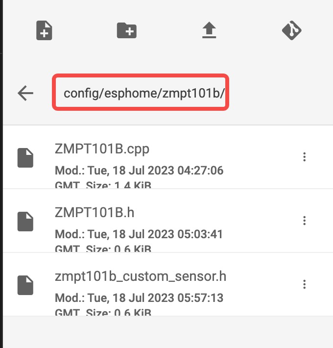

before you config ymal file, please upload zmpt101b folder to home assistant disk:
unzip files, 3 files upload to disk folder as image.

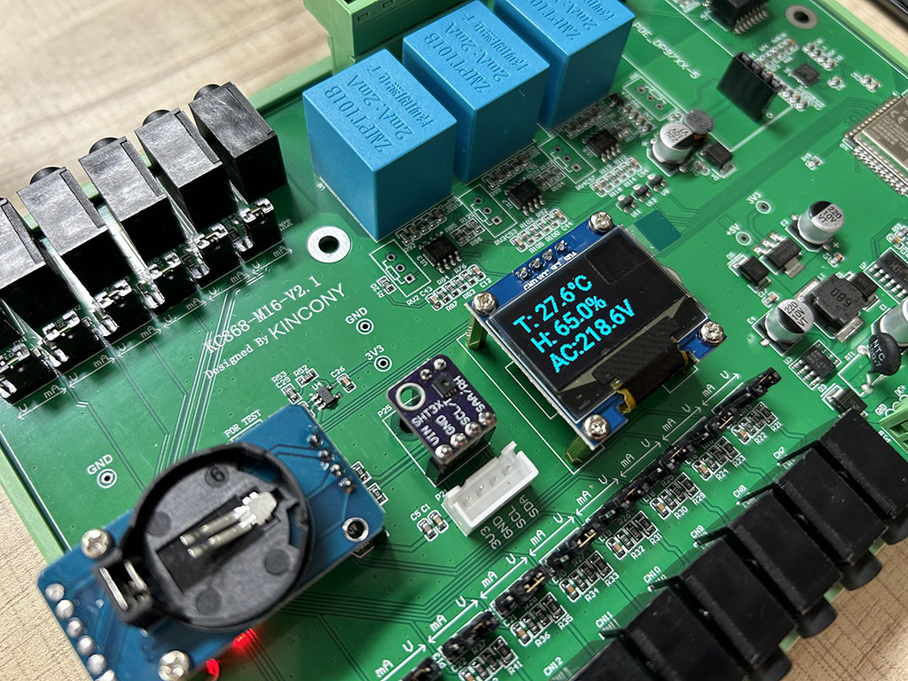

display:
  - platform: ssd1306_i2c
    model: "SSD1306 128x64"
    address: 0x3C
    lambda: |-
      it.printf(0, 0, id(roboto), "T: %.1f°C", id(temperature).state);
      it.printf(0, 20, id(roboto), "H: %.1f%%", id(humidity).state);
      it.printf(0, 40, id(roboto), "AC:%.1fV", id(voltage_2).state);

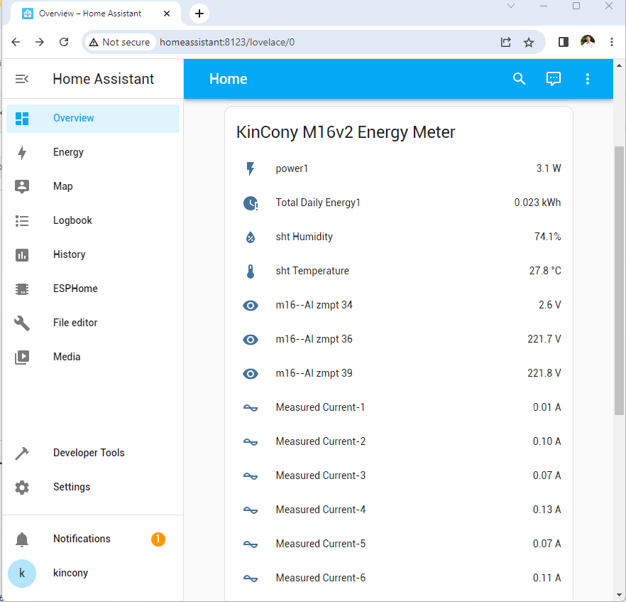

      - name: "m16--AI zmpt 34"
        unit_of_measurement: V
        accuracy_decimals: 1
        state_class: "measurement"
      - name: "m16--AI zmpt 36"
      - name: "m16--AI zmpt 39"

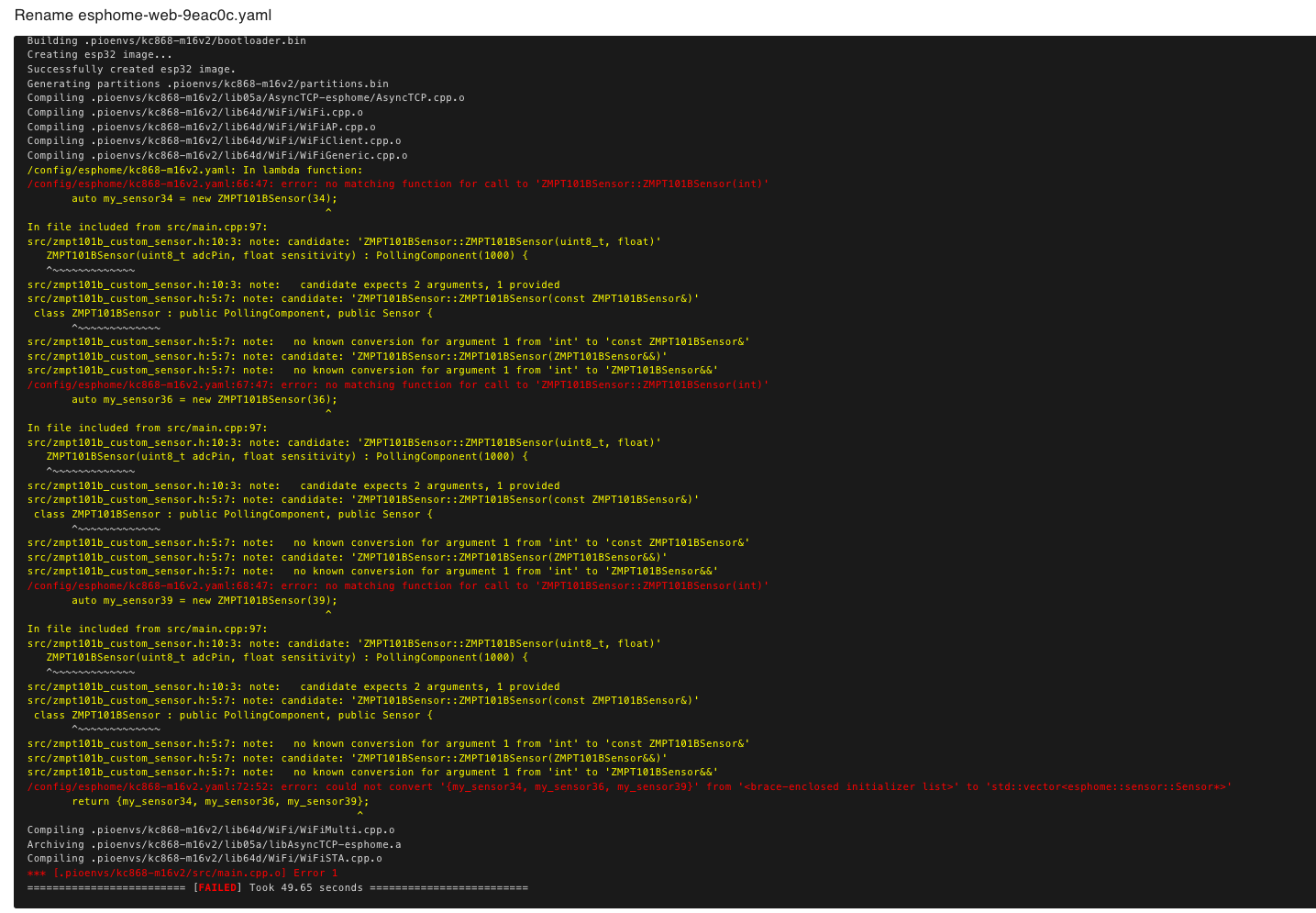

Hi,
Today I received my KC-868-M16-V2.1
I copied the files to the correct folder and created an yaml definition file for the board as described in this post.
During the compile of the yaml file //i get the errors below in the screenshot, any help is more than welcome, because I'm out of options.
take a photo of your component folder and file structure.

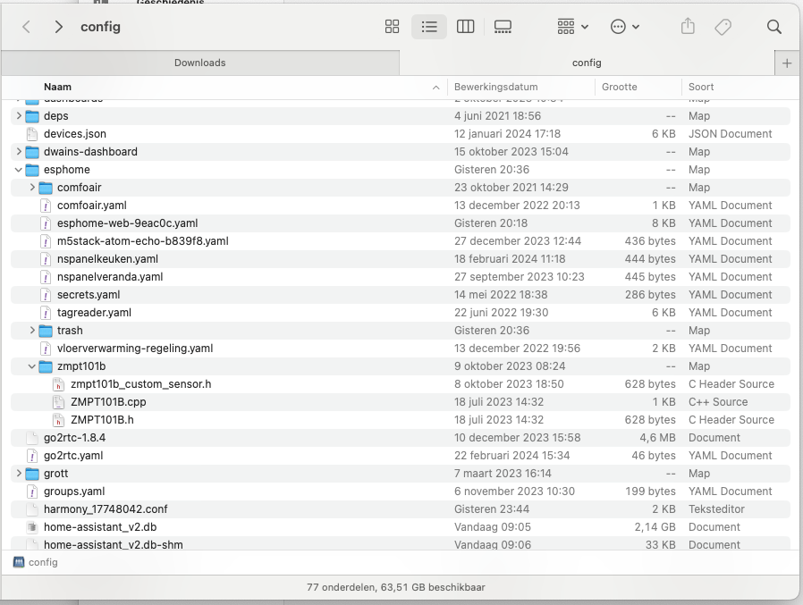

(02-28-2024, 09:47 PM)admin Wrote: take a photo of your component folder and file structure.
I guess you mean this?
Any news on this issue?
do you install your home assistant on a raspberry pi? i suggest you delete your ESPhome, re install it.
it's correct as your photo about fold and files.
My home assistant is running on an ODROID N2+ and I have tried to reinstall ESPhome, but without any luck.
the easiest way, you can install ESPHome on your computer or raspberry pi (not use ODROID N2 hardware), compile these code directly to test it. Because all our customers work well, so i think maybe some environment issue.
