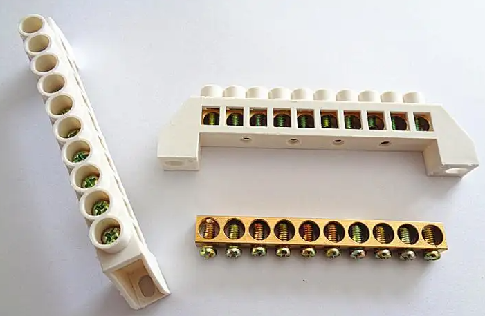

"one terminal pole per lamp" is ok.

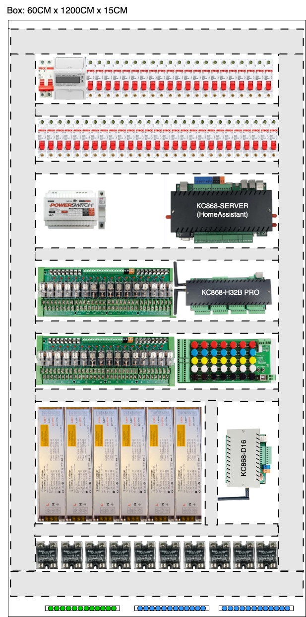

i think you can use KC868-H32B Pro relay controller for ON/OFF devices.
KC868-AG Pro for air conditioner.
IP camera you can chose any TUYA solution product.
if you want control fan speed, you can add KC868-D16 dimmer controller + SSR for AC220V load.
KC868-Server to install home assistant software.

ok, no problem, just post at here.
