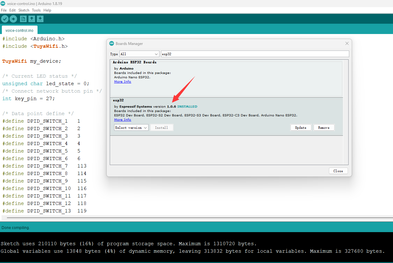

Tuya adapter V2 arduino source code - 32CH virtual switch
#include <Arduino.h>
#include <TuyaWifi.h>

esp32 board need V1.0.6 verision:
tuya arduino library config file set to "0". because use ESP32's GPIO for BUTTON and LED with Tuya network function, just set as photo:
if you want modify arduino source code to control your own board, you can insert control relay code at here.
