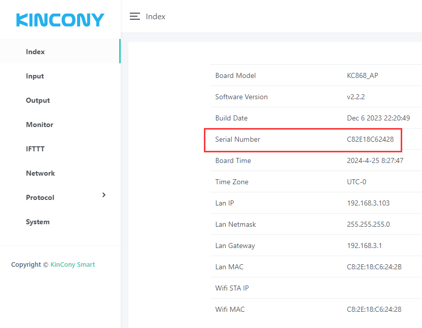

next week when have free time, will test it.

Thank You very much, is working well, have you maybe a method for control rgb or rgbw light on separate or combined dac channel
In esphome is possible to control an rgb entity, is possible to combine tree or four channels as rgb or rgbw entity to control it in mqtt ?
