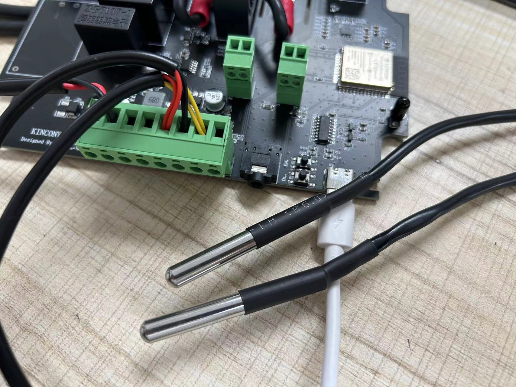

the photo have connect with "SDA" pin on M1 board, actually you can also use "SCL" pin, these two i2c pins both have pull-up resistance on PCB.
then you can config it by ESPHome, after download firmware will found all scaned DS18B20, remember the sensor's address replace in yaml file.
