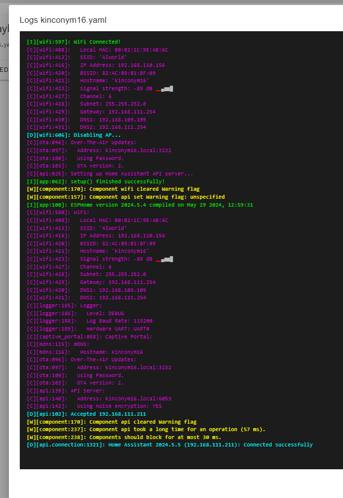

I'm trying to configuring it through Home Assistant (this worked fined for the M30 model). I can upload the yaml by USB, and the node is getting nicely his IP from the WIFI network. Home Assistant can find the node, and adds it in his config (manually by IP). But I'm only getting 1 entity for this node?
When I check the logs, I've got the feeling that the M16 isn't doing anything? In the M30 logs, I've got more activity.
See the print screen, it just 'hangs' there.
Also the display on the board isn't lighted up, no text with other words.
Any idea what I can do to solve this?

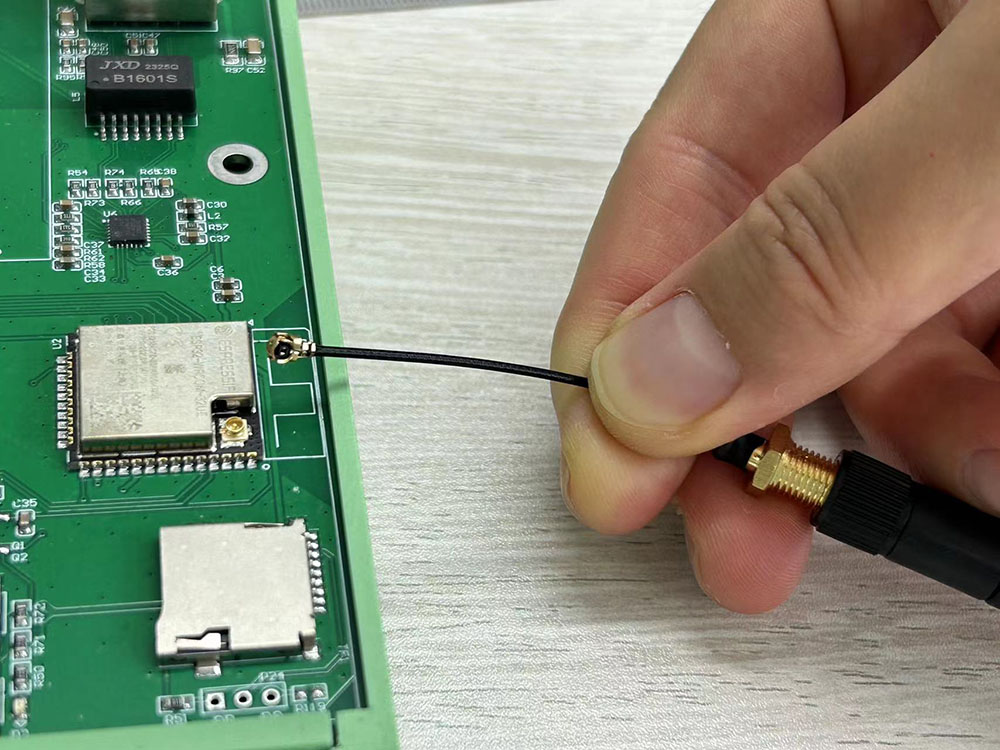

if you use wifi with M16v2 board, do you have installed wifi antena? take a photo of your board.
#13
(05-29-2024, 10:39 PM)admin Wrote: if you use wifi with M16v2 board, do you have installed wifi antena? take a photo of your board.
No antenna, didn't get an antenna with the package?
I'll check this evening if I've got somewhere an antenna that fits the connector...
On the other hand, I see a good ping result (the board is about 3 meters from the Access Point).
If you think that this can be the reason, I can also always check with a wired network connectivity.
#14
we suggest to use ethernet, the product without wifi antena. if you want to use wifi, now you have not installed wifi antena. find a IPEX extender wifi antena to use, will be solved.
#15
(05-30-2024, 06:36 AM)admin Wrote: we suggest to use ethernet, the product without wifi antena. if you want to use wifi, now you have not installed wifi antena. find a IPEX extender wifi antena to use, will be solved.
With a WIFI antenna it started working (after reloading the yaml file)!
Thanks!!!
