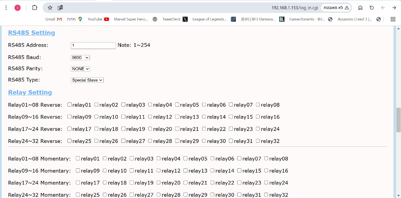

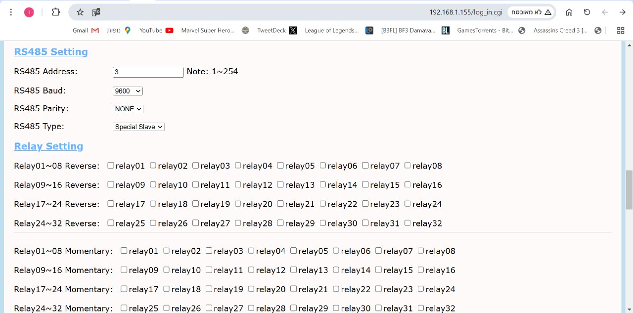

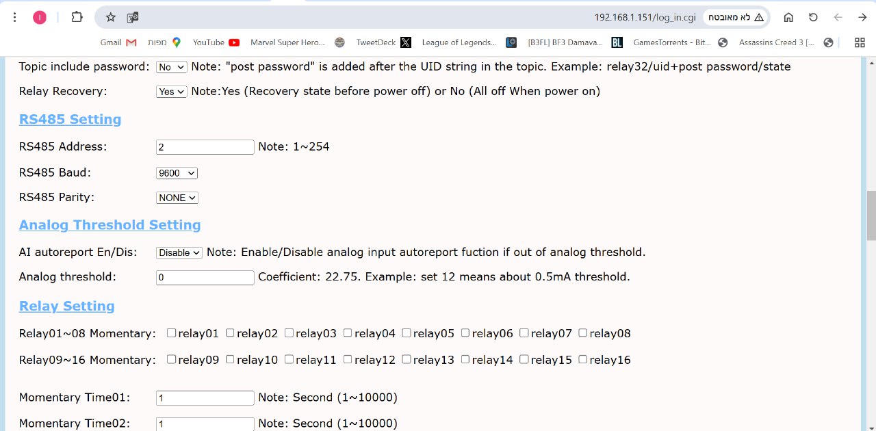

Hello admin,
I tried to configure the components according to the links you attached and unfortunately I could not find how to configure the ak to turn on or off the relay using RS485.
I have attached pictures of the configuration of each component.
can you please attach an example of how to configure the customsize protocol for RS485
 so that the relay Number one in H32B PRO can be turned on by button number 1 in AK and relay number 2 in Server turned on by button number 2 in AK
and what The RS-485 syntax
KCS v2 use IFTTT to control relay board.
here is RS485 modbus command document: https://www.kincony.com/forum/showthread.php?tid=2528
if you only use KC868-AK to control H32B relay controller.  i suggest you download this original firmware, easy to use.
.zip   kc868-ak-v1.0.7.zip (Size: 453.15 KB / Downloads: 787)
