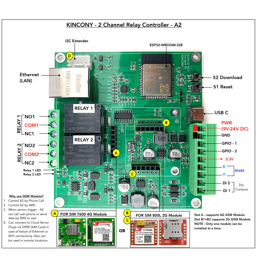

How are all the pins from the module connected? I'm especially interested in where the RST pin is connected. Thank you.

Which pin is the ESP connected to? In the video I saw that all the pins are connected to the board but I couldn't find any information on which ports the ESP is connected to. I need the RST pin to be able to reset the GSM module as it sometimes freezes.

That's exactly what I'm asking. SIM800L is connected to a board with a fully installed pin header. From the schematic it's not entirely clear to me where the individual pins go to the esp32. How should I connect the RST pin to the esp32 when I have SIM800L connected to the pin header. If I understand correctly, pin headers C and B from the picture are used to connect the SIM800L.

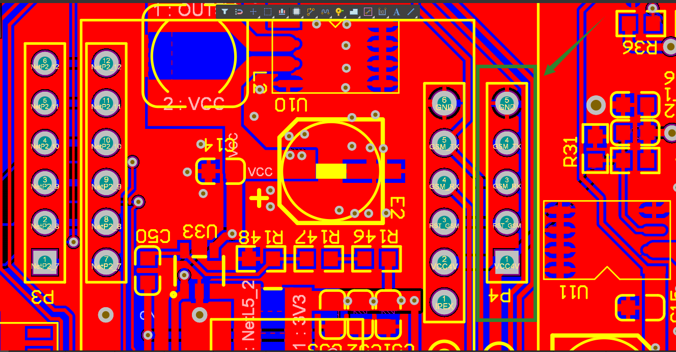

B and C in image is SIM800L, you can check pin define on RED pcb, there are lable for pins.
on KC868-A2 PCB SIM800L socket pin define see this photo:
Posts: 6
Threads: 1
Joined: Feb 2024
(12-20-2024, 12:21 AM)admin Wrote: B and C in image is SIM800L, you can check pin define on RED pcb, there are lable for pins.
From this it is not entirely clear to me where the output (3)RST_GSM leads. On the board there is only a connection between (3)RST_GSM and (2)RST_GSM? I want to connect this PIN to some free ESP32 IO. Please advise where to make the connection. Thank you.
Posts: 10,587
Threads: 1,593
262
only GSM_TX and GSM_RX from ESP32's pin, it's free GPIO.
