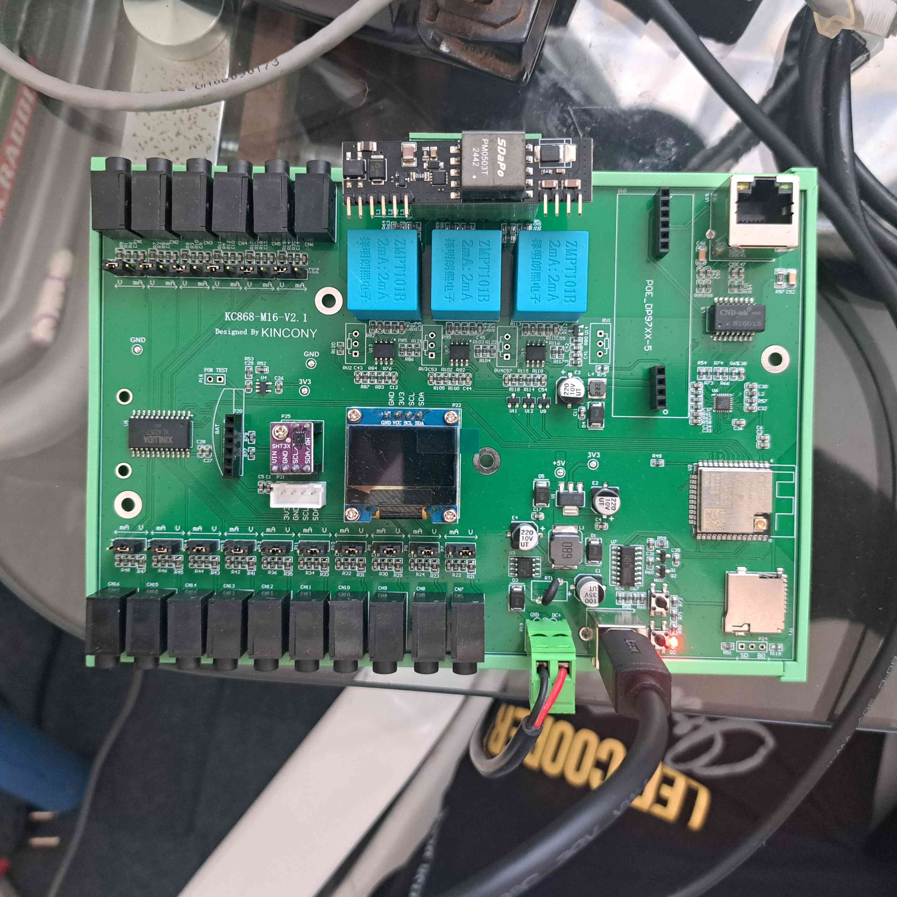

take a photo of your board. also take a photo of your POE module, i need to see the label on POE.
(12-25-2025, 12:24 PM)admin Wrote: take a photo of your board. also take a photo of your POE module, i need to see the label on POE.
As requested
if connect POE switch, whether M16v2 power LED on?
(12-26-2025, 08:13 AM)admin Wrote: if connect POE switch, whether M16v2 power LED on?
Yes.
See image of the board and switch. only 1 light on at the switch side. No led lights on at the network port on the board.
Yes.
Managed to be successful.

i want to use poe. my one is not working. i connect to poe switch with a category a or category b lan cable. port led on poe switch both on. lan port led on the board, only orange blink and go off. about 20 seconds repeat.
take a video of your problem, send to whatsapp number: +86-15381188302
(12-27-2025, 08:45 AM)admin Wrote: take a video of your problem, send to whatsapp number: +86-15381188302
will see how i can send, i'm not a whatsapp user.
