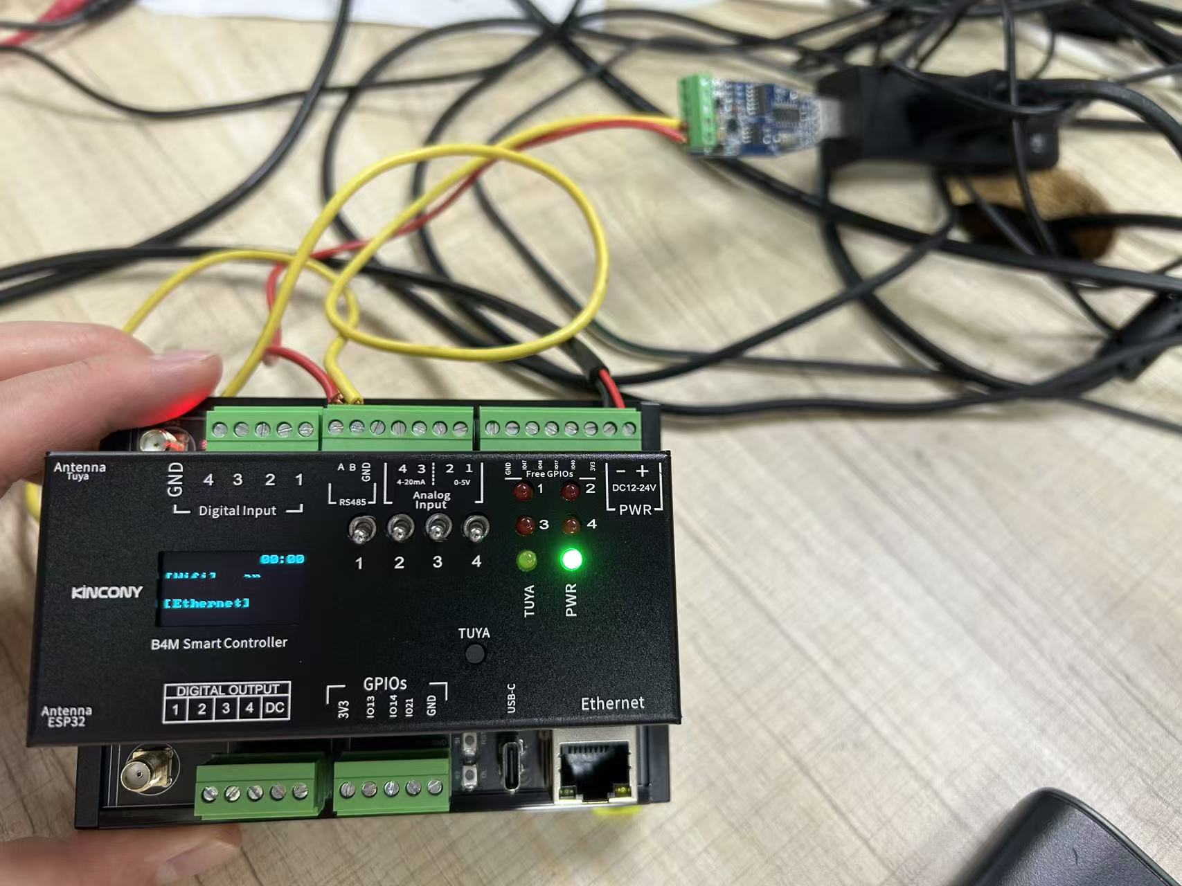

take a photo of your arduino screen .

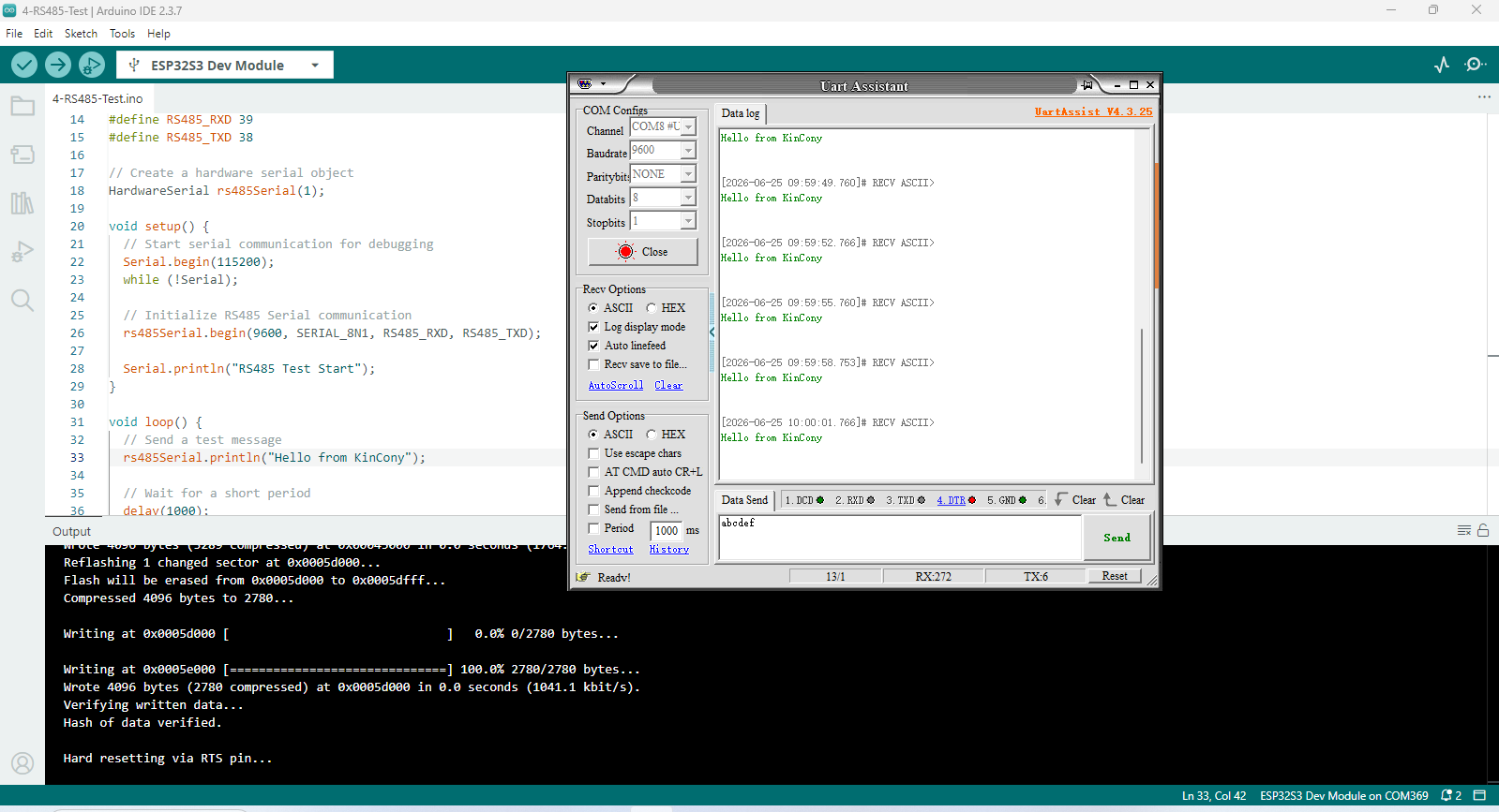

tomorrow i will test, then feedback to you.
* Made by KinCony IoT: https://www.kincony.com
* RS485 Communication Test
* This program is a simple test for RS485 communication using ESP32-S3.
* It will send a message over RS485 and then read incoming messages.
* The TXD pin is defined as GPIO 18 and RXD pin is defined as GPIO 8.
#include <HardwareSerial.h>
// Define RS485 pins
#define RS485_RXD 39
#define RS485_TXD 38
// Create a hardware serial object
HardwareSerial rs485Serial(1);
void setup() {
  // Start serial communication for debugging
  Serial.begin(115200);
  while (!Serial);
  // Initialize RS485 Serial communication
  rs485Serial.begin(9600, SERIAL_8N1, RS485_RXD, RS485_TXD);
  Serial.println("RS485 Test Start");
void loop() {
  // Send a test message
  rs485Serial.println("Hello from KinCony");
  // Wait for a short period
  delay(1000);
  // Check if data is available to read
  if (rs485Serial.available()) {
    String receivedMessage = "";
    while (rs485Serial.available()) {
      char c = rs485Serial.read();
      receivedMessage += c;
    // Print the received message
    Serial.print("Received: ");
    Serial.println(receivedMessage);
  // Wait before sending the next message
  delay(2000);

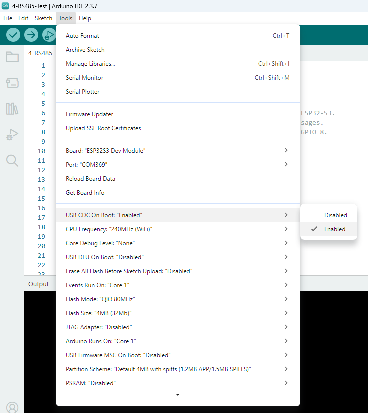

make sure you have enabled "USB-CDC-On boot" option.
