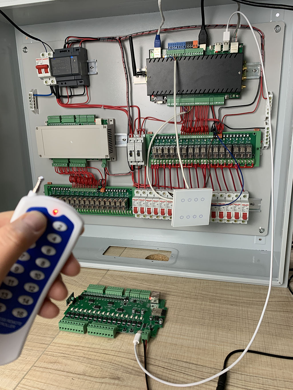

1. Monday will feedback to you.
2. if RF receiver module really have problem, we can send you a new one.
3. OK, when have free time, we make a video tour based on KC868-A16 to use RF433Mhz function.
#23

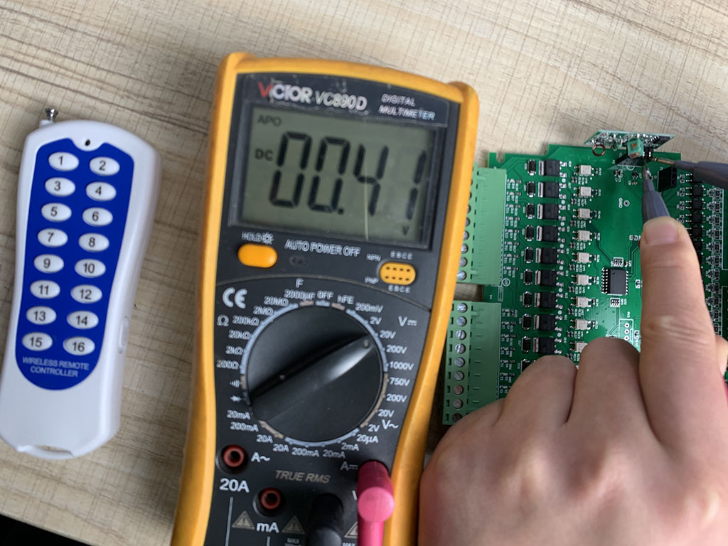

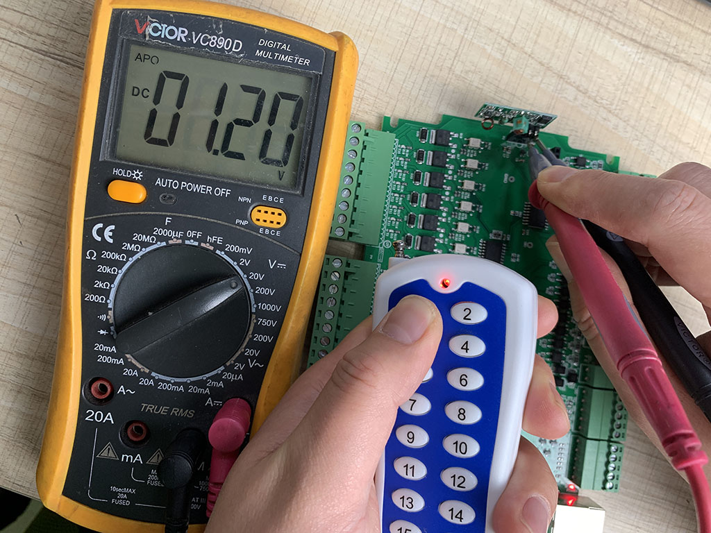

we have check, when no remoter button pressed, the DATA of RF receiver's module is almost 0v
when any remoter button pressed, it showed about 1v.
i think your RF receiver module is broken, next time when you order, tell the seller, we can send you a new one.

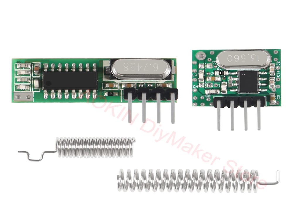

Thanks so much for the help, no need to send me another module I already ordered a few this weekend. One more question, what do you think about another RF reception module with antenna, can it be used instead of the one that comes with the standard board? Picture attached. ( https://www.aliexpress.com/item/32980820...18022epdMa )
#25
i think it can use. just connect with receiver module's VCC,GND,DATA to A16 PCB's pin.

Today I installed the new 433 Mhz RF reception and transmission modules. Unfortunately the same result, I can not see any code in the log inside K868-A16 with ESPHome.
I also took measurements. When I do not press any button on the remote control, the voltage is almost 0.014 V. When I press any button on the remote control, the voltage remains the same, it does not change.
I think there's something wrong with this board. It's hard for me to believe that the new RF module is also defective.

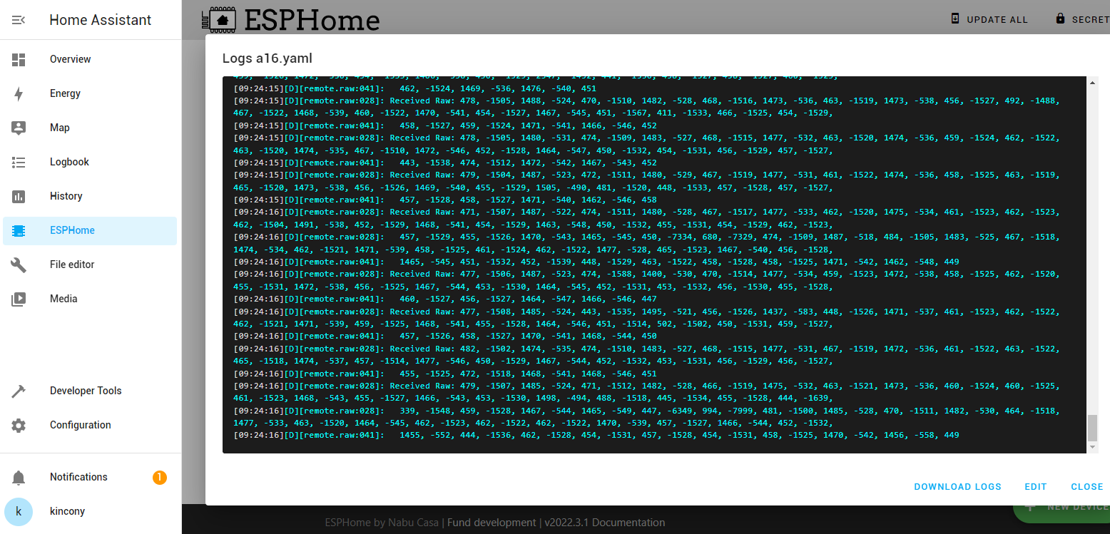

you can use my config file, have test.
.txt   A16-config-HA-RF-decode.txt (Size: 522 bytes / Downloads: 867)
