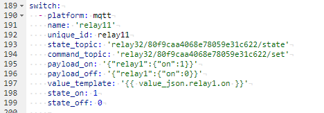

before MQTT config format:
  - platform: mqtt
    unique_id: relay11
    state_topic: 'relay32/80f9caa4068e78059e31c622/state'
    command_topic: 'relay32/80f9caa4068e78059e31c622/set'
    payload_on: '{"relay1":{"on":1}}'
    payload_off: '{"relay1":{"on":0}}'
    state_on: 1
    state_off: 0

Please Let me know why mqtt config update like this?
1. What is difference? before and after?
2. If not. It has any problem?
I have already updated V.4.44 and attached RC snubber. But Sometimes mqtt in KC868-h32b has no response until reboot.
Thank you.
home assistant RC 2022.6 version need this, at 2022.9 version will stop use old mqtt format. details see: https://www.home-assistant.io/blog/2022/...ase-20226/
