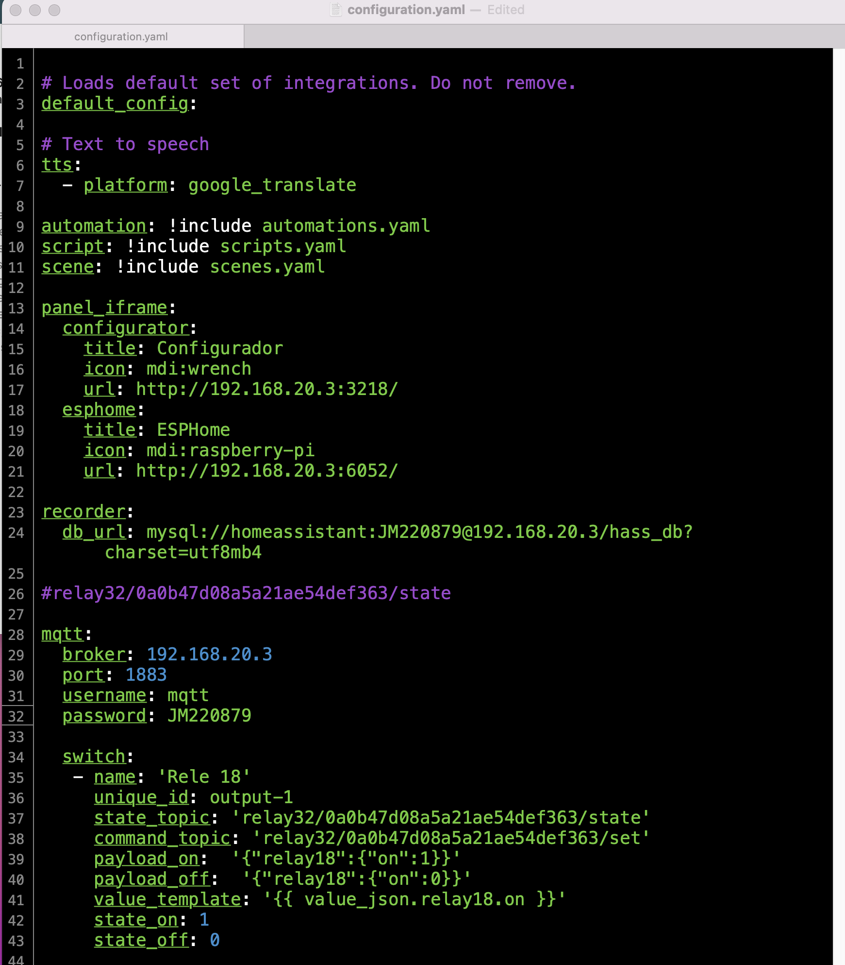

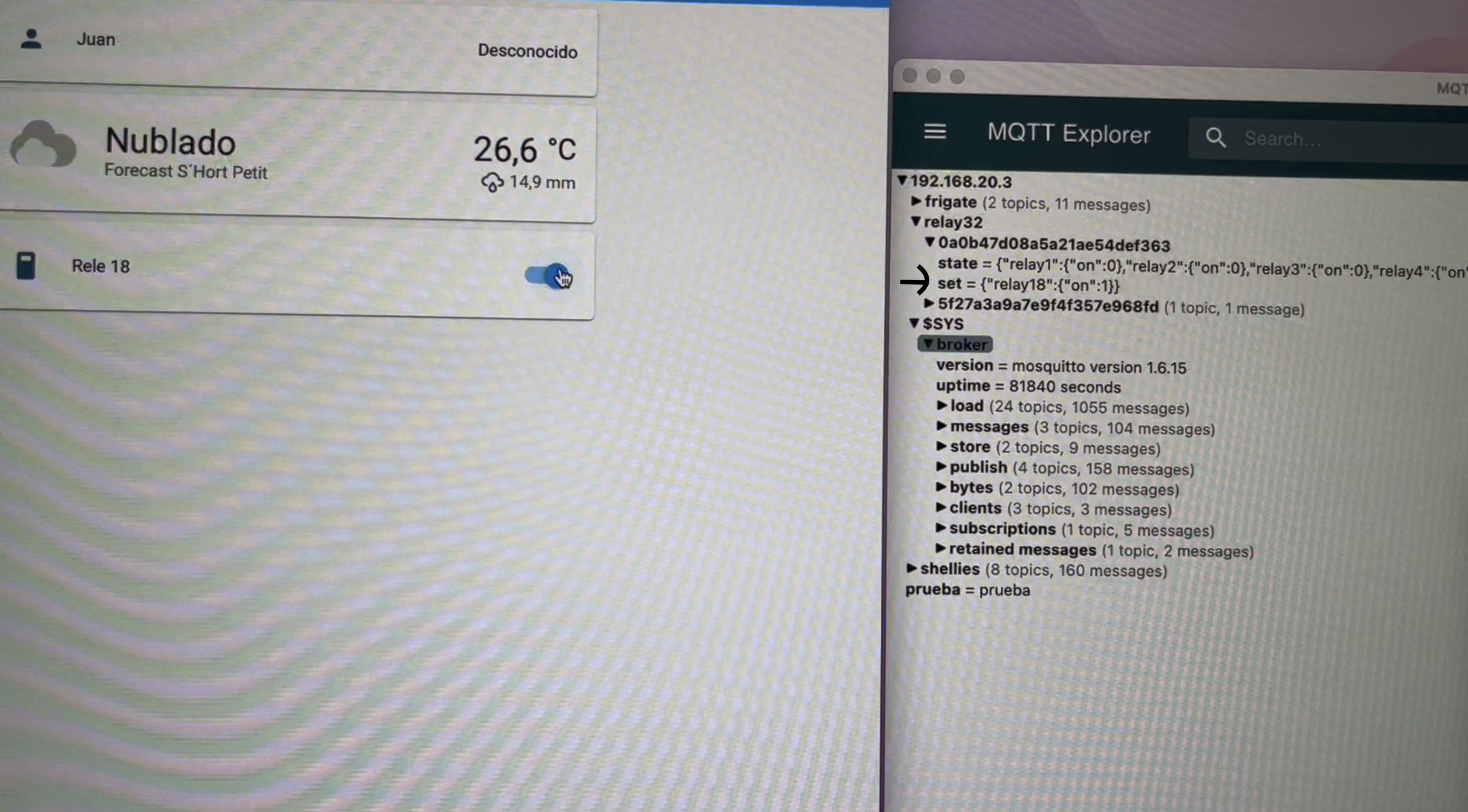

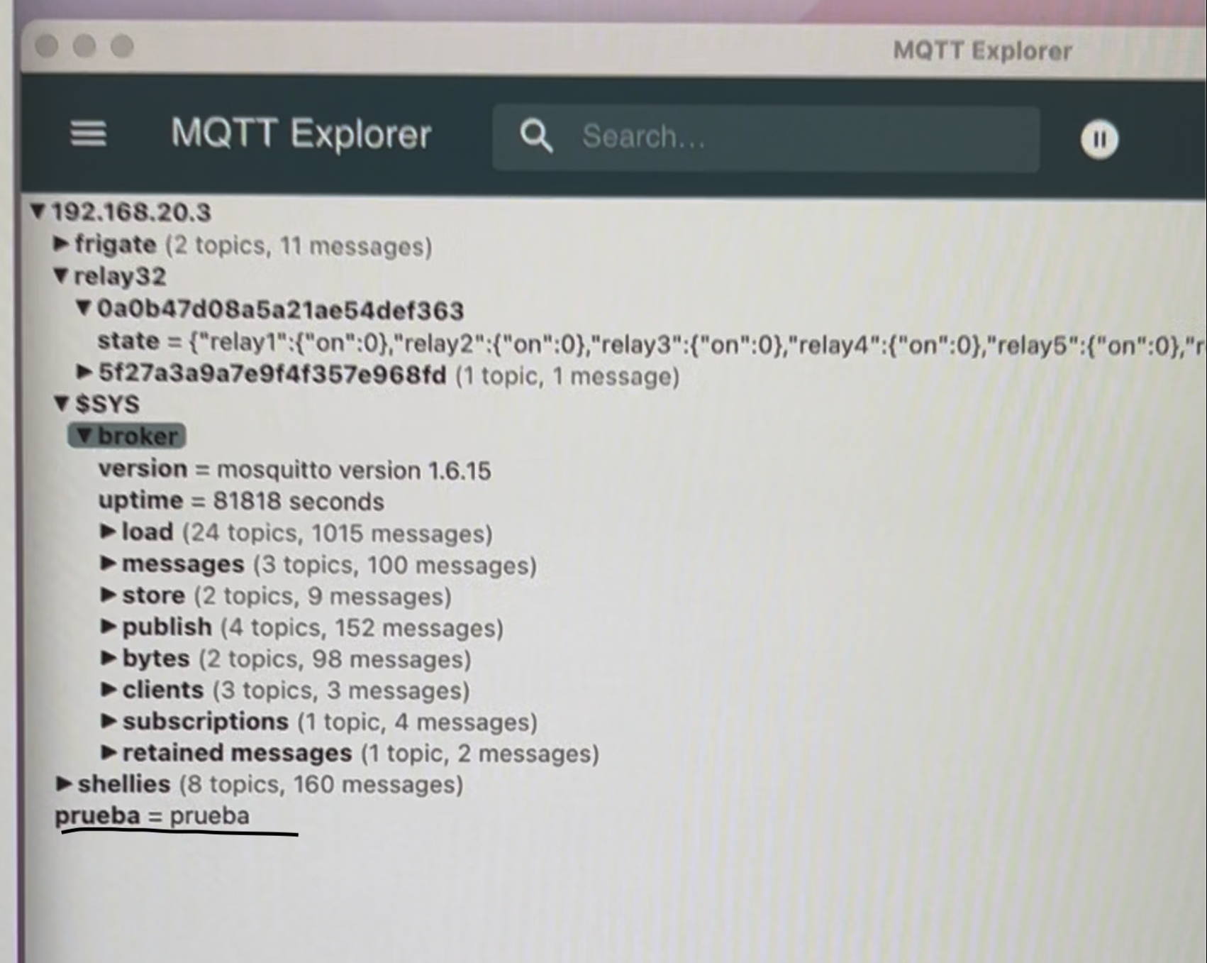

I'm sorry, I actually use the KC868-H32B controller, in fact, if I connect to the MQTT server directly, I can see how the states of the relays and inputs are published, but I cannot act on it from the home assistant. From a third-party application such as MQTT explorer, I can modify the states of the relays by publishing directly on the MQTT server, so I understand that the problem is on the Home Asisstant side.
