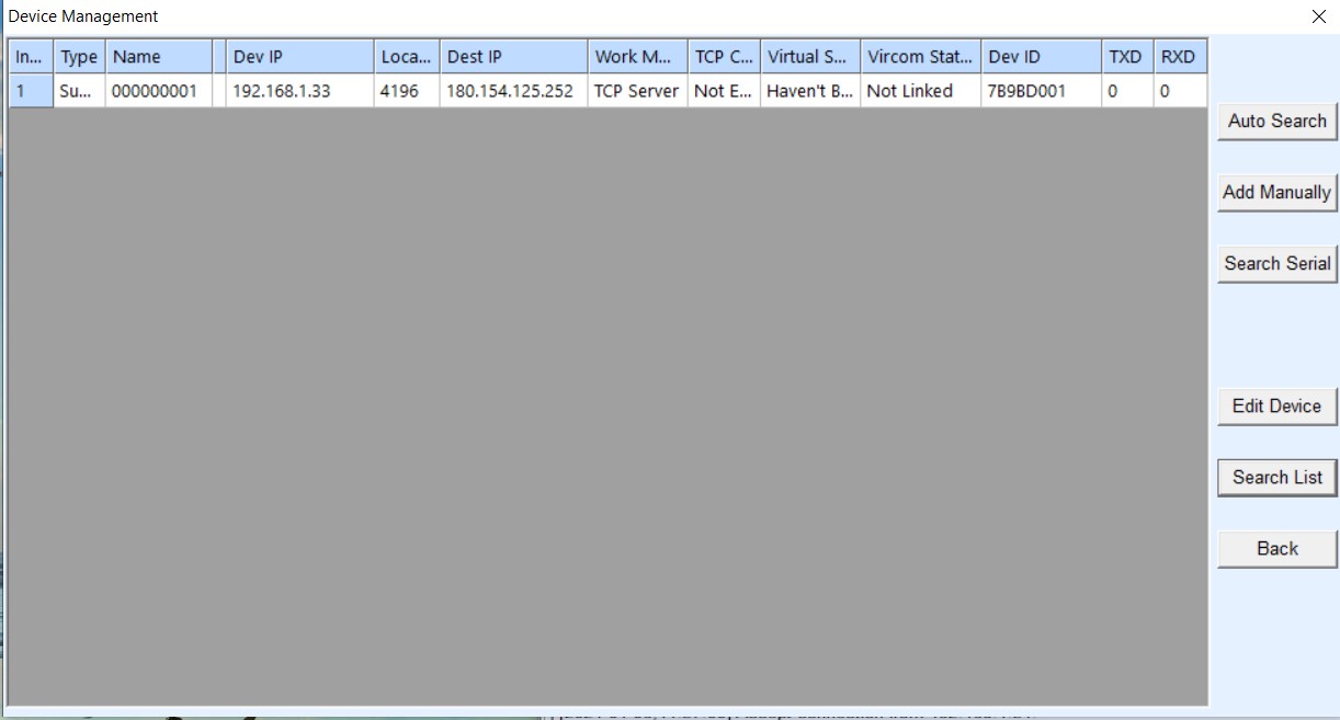

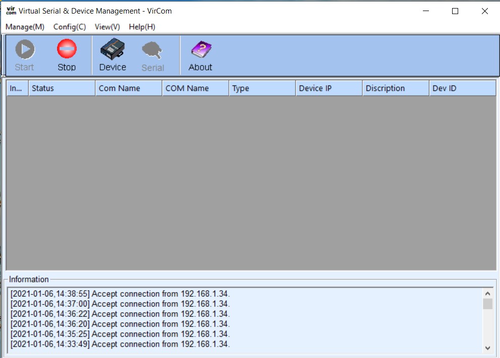

I am beginner, and i can't connect my KC868 COL to the LAN, the vircom can't find the device. The controller is connected to the LAN.
can someone help me ?

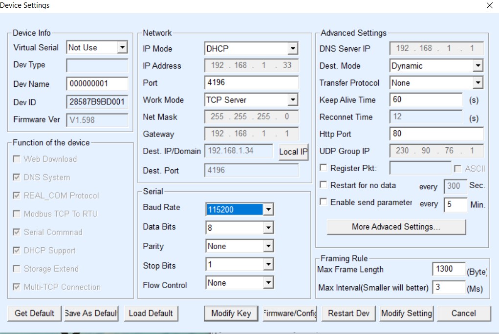

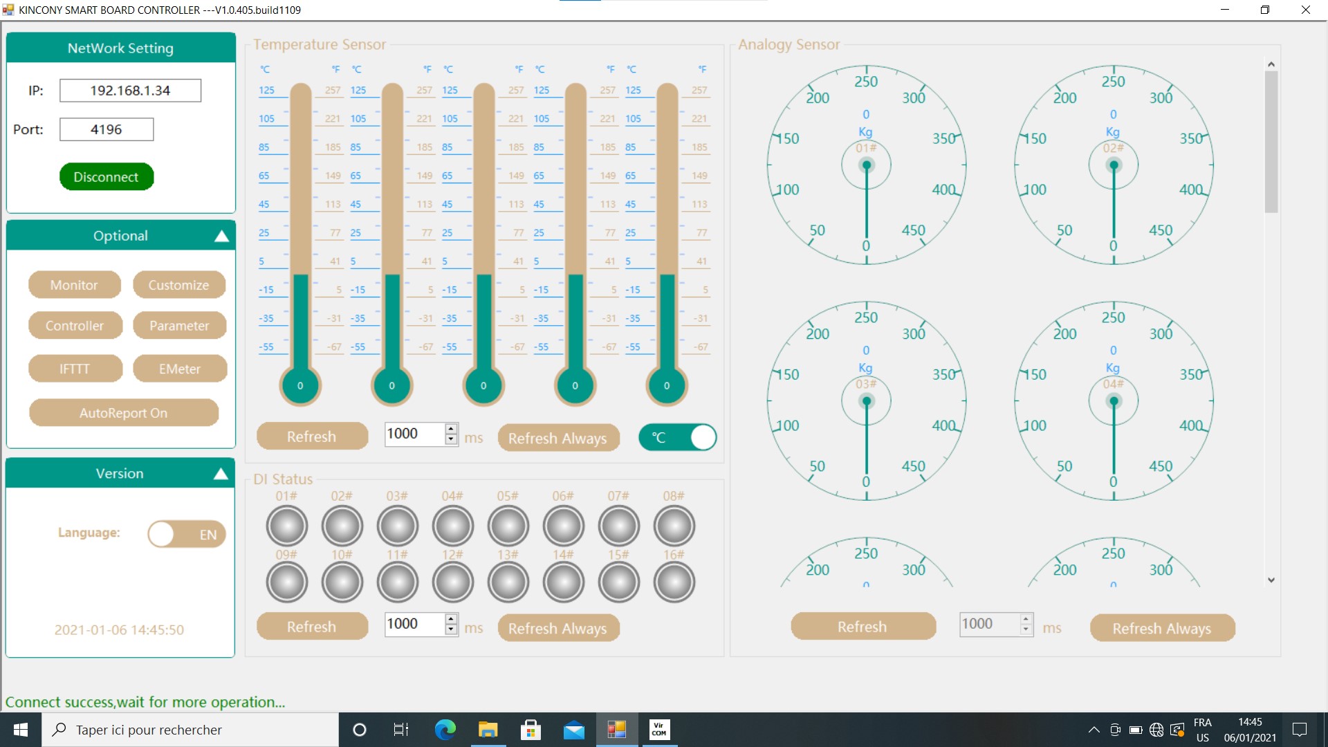

Your COL IP is 192.168.1.33 so you need set IP =192.168.1.33 in COL's PC software, but now you have fill ip = 192.168.1.34, it's wrong.
Posts: 10,316
Threads: 1,528
256

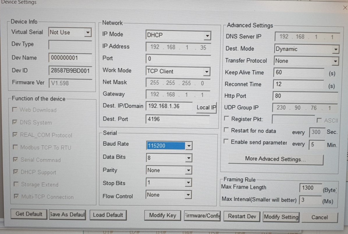

Your COL is work as a server, your PC is a client, PC connect to COL, not COL connect to PC.
