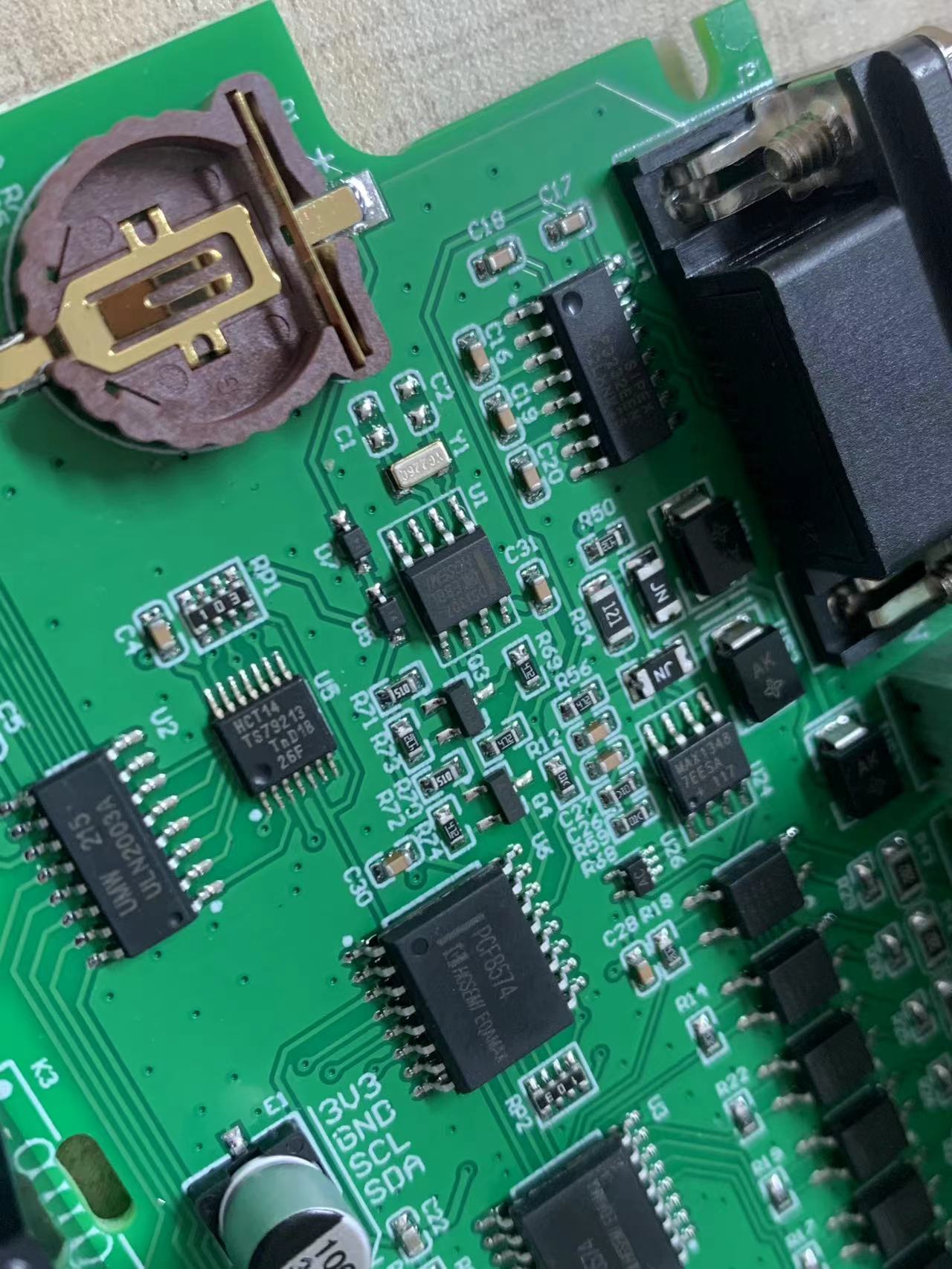

Looking closely at the circuit board, just near the DS1307 chip, the capacitors C1 and C2 are missing.
Would this be the issue?

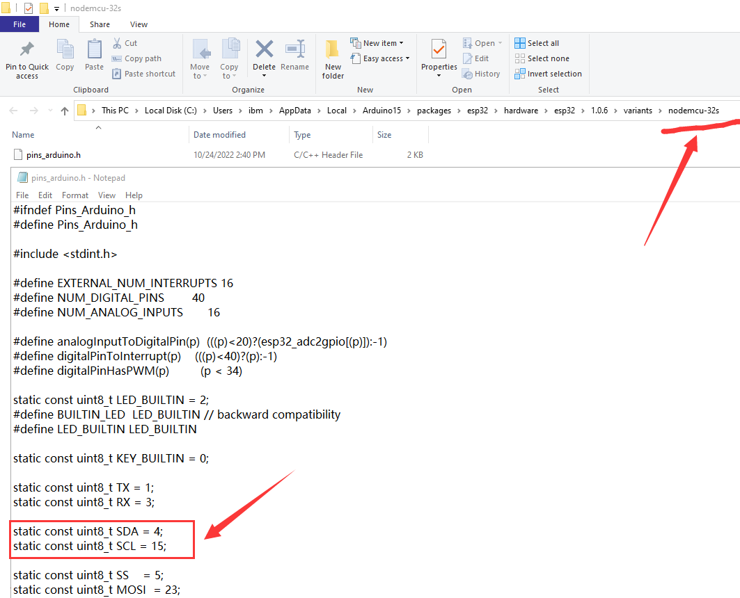

- I've been adjusting the SDA and SCL in the pins_arduino.h file

Can you compare my photos carefully to see if there are any missing components on the PCB board.
Hi again
I've looked over the board and I can't see anything missing or any cracks in any tracks etc.

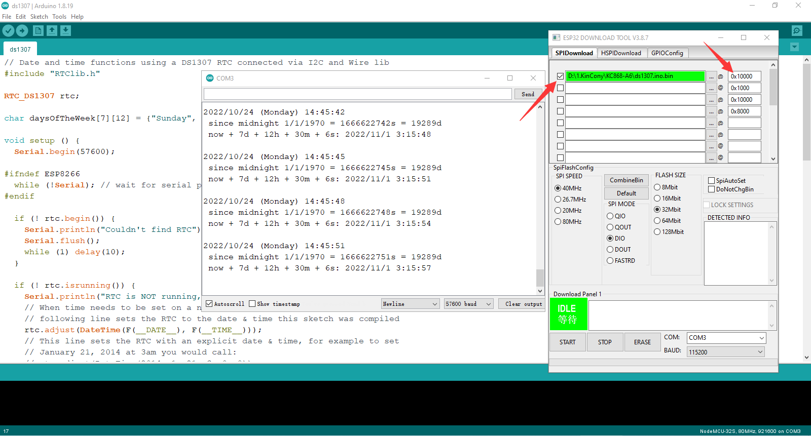

tested your BIN file, work well. make sure download to 0x10000 address, see the photo.
