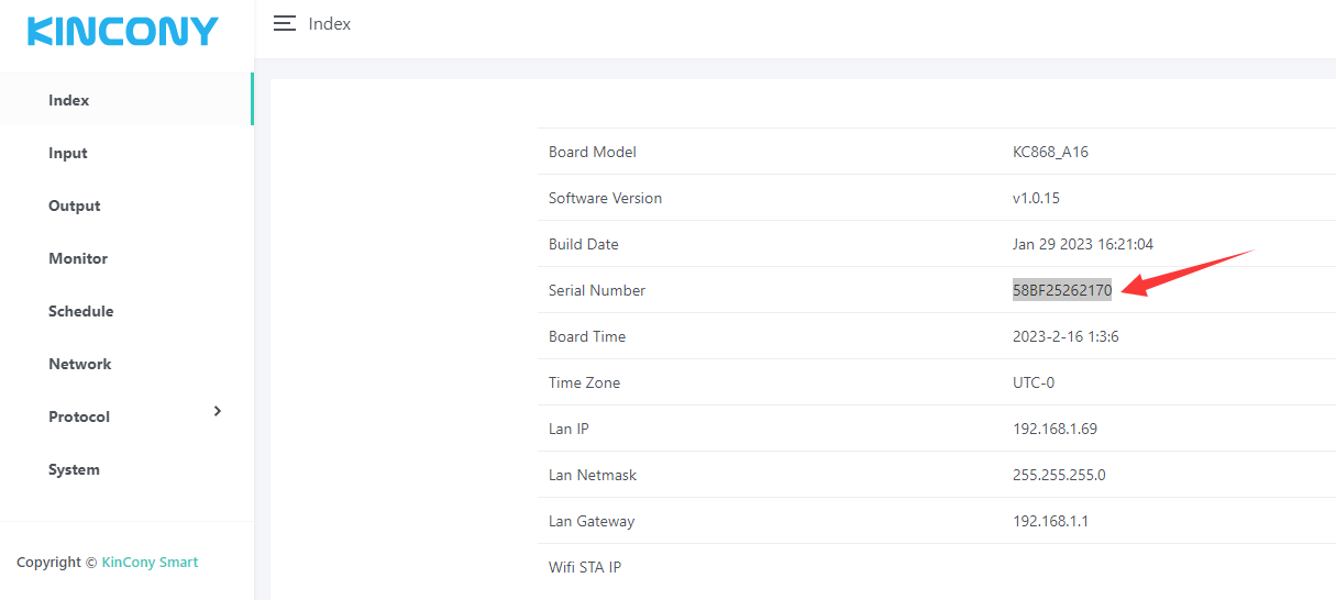

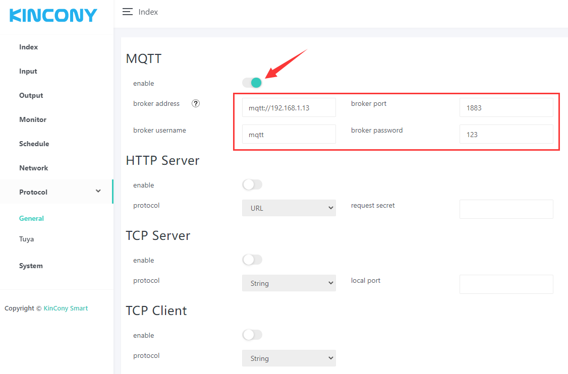

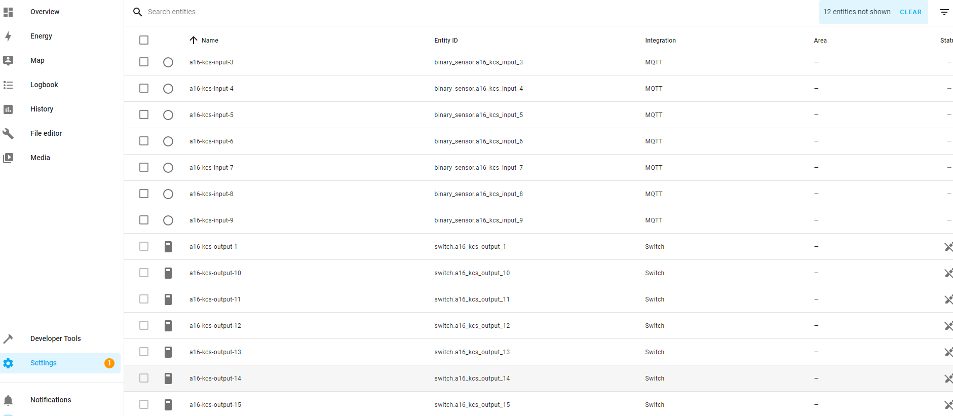

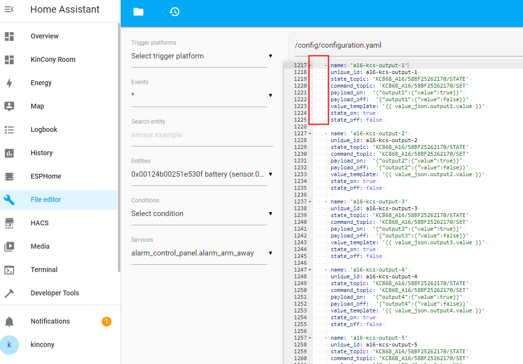

maybe your code have some format problem, i can't see. you can copy text to "Notepad" then copy to home assistant file editor. Here is I have tested with KC868-A16 integrate with home assitstant by MQTT via "KCS" v1.0.15 firmware.
.txt   A16-mqtt-home-assistant.txt (Size: 9.33 KB / Downloads: 639)
#13

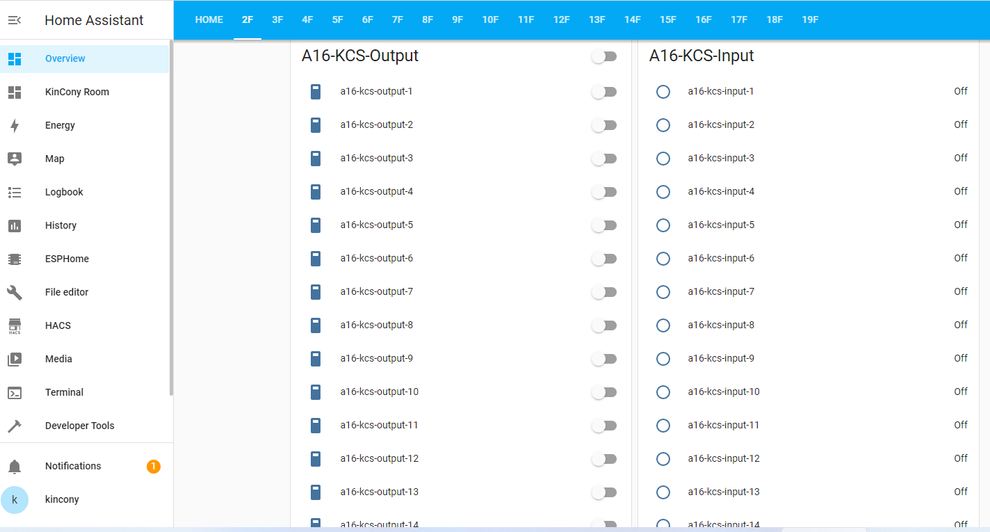

(02-16-2023, 01:27 AM)admin Wrote: maybe your code have some format problem, i can't see. you can copy text to "Notepad" then copy to home assistant file editor. Here is I have tested with KC868-A16 integrate with home assitstant by MQTT via "KCS" v1.0.15 firmware.
works well, thank you very muchSmile
