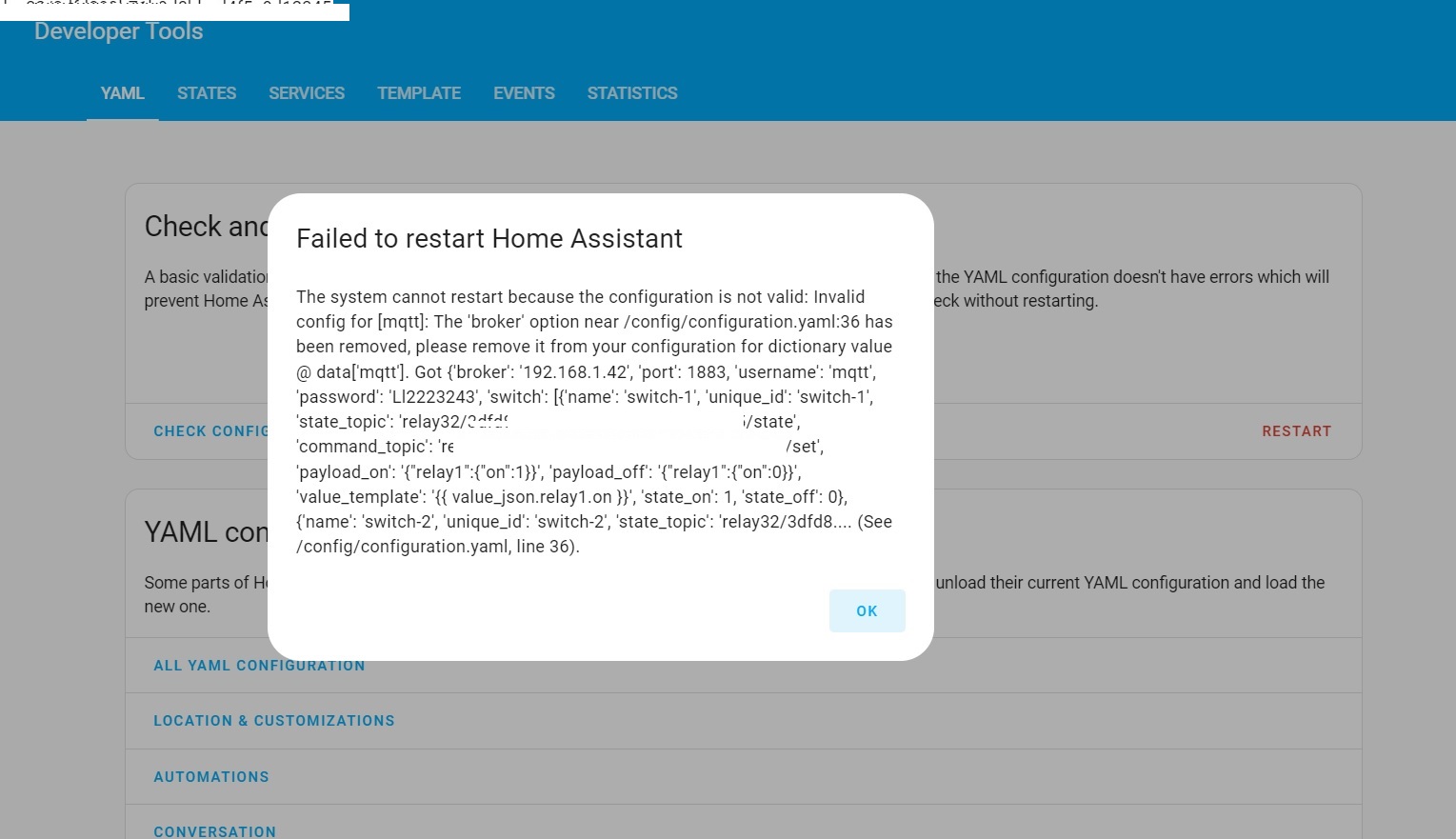

04-08-2023, 07:33 PM
(This post was last modified: 04-08-2023, 07:34 PM by Alex1987sar.)
hello
I use kc868-h32 via TCP\IP and this manual https://www.kincony.com/home-assistant-r...odule.html there is a problem whis a code how to solve it? HA says: nvalid config for [mqtt]: The 'broker' option near /config/configuration.yaml:19 has been removed, please remove it from your configuration for dictionary value @ data['mqtt']. Got {'broker': '127.0.0.1', 'port': 1883, 'discovery': True, 'discovery_prefix': 'homeassistant'}. (See /config/configuration.yaml, line 19).
04-09-2023, 12:14 AM
if you are using KC868-H32 old controller, it's not support MQTT. you can take a photo of your controller whole box. let me have a look.
04-09-2023, 04:35 AM
just remove the mqtt broker lines in configure.yaml file will be work fine.
04-09-2023, 04:50 AM
Now it works fine, thank you
I removed the following broker: 192.168.1.42 port: 1883 username: xxxxxx password: xxxxxxxx
04-09-2023, 05:36 AM
ok
