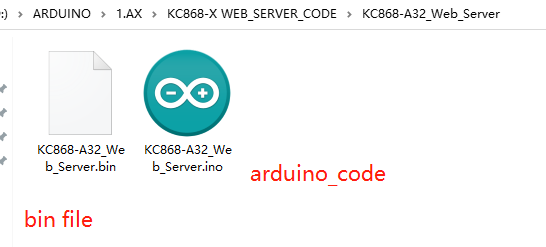

.zip   KC868-A32_Web_Server.zip (Size: 483.68 KB / Downloads: 1,028)
* Create Your own WebServer for KC868-A32 Smart Controller*
