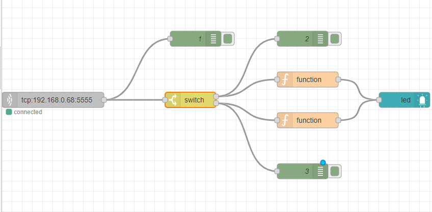

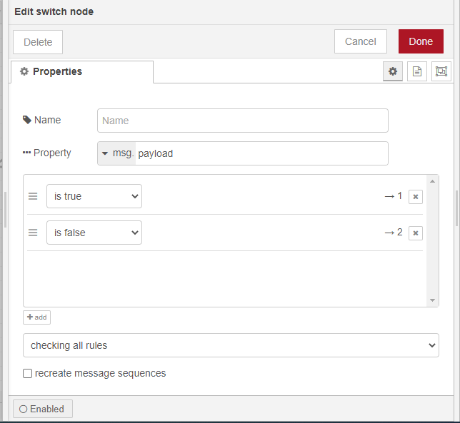

use "switch" and "function" node to convert.

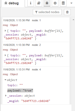

11-06-2020, 03:51 AM
(This post was last modified: 11-06-2020, 03:53 AM by admin.)

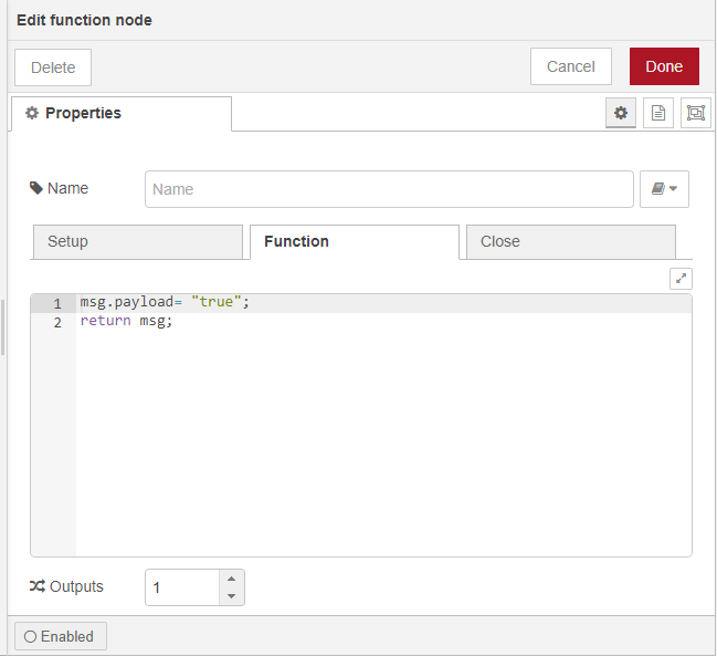

your up "function" node:
msg.payload= "true";
return msg;
your down "function" node:
msg.payload= "false";
return msg;

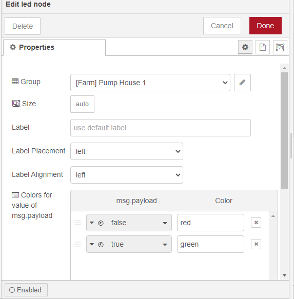

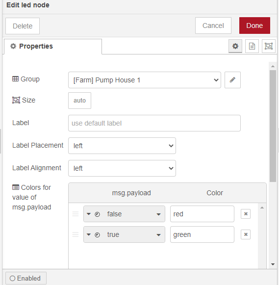

Posts: 10,336
Threads: 1,529
256
yes, if have "" is a string format, not boolean.
