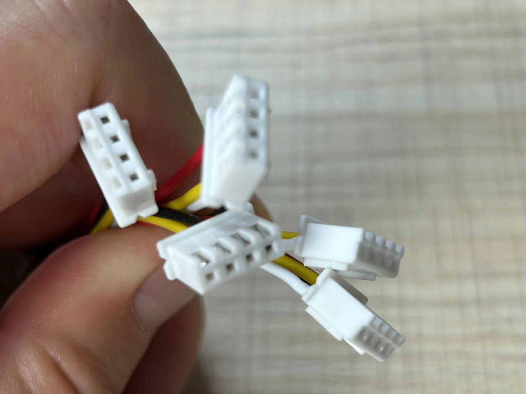

I order a number of I2C connectors intending to use them on the 868-A6 board but none of them are the correct size. Can anyone provide the specifications for the female connectors or refer me to a site/s that has the specific connectors, please? I would appreciate a specific part or part number.
Thanks
it's 2.54mm socket. here are photos.
Just google "Mini Micro JST XH 2.54mm 4 Pin Connector" and you will find what you need. I ordered a 10 pack and they fit just fine. Got mine on EBAY.
(05-20-2023, 11:20 PM)Philadam Wrote: Just google "Mini Micro JST XH 2.54mm 4 Pin Connector" and you will find what you need. I ordered a 10 pack and they fit just fine. Got mine on EBAY.
Thanks. I order from Aliexpress thinking they were all the same size.
