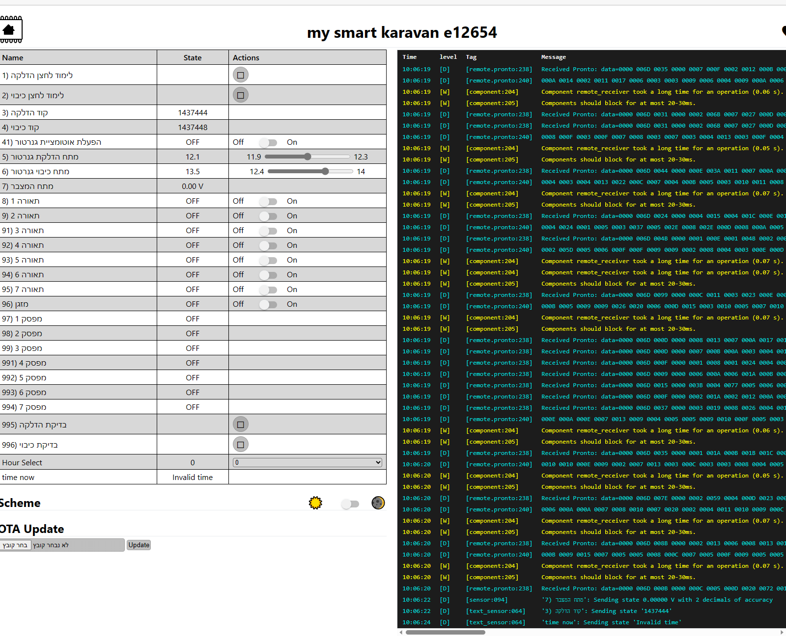

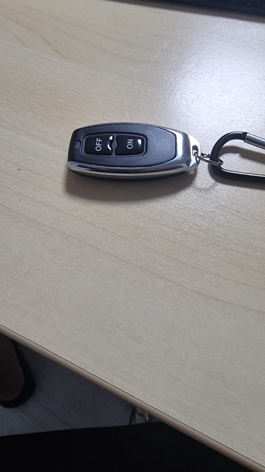

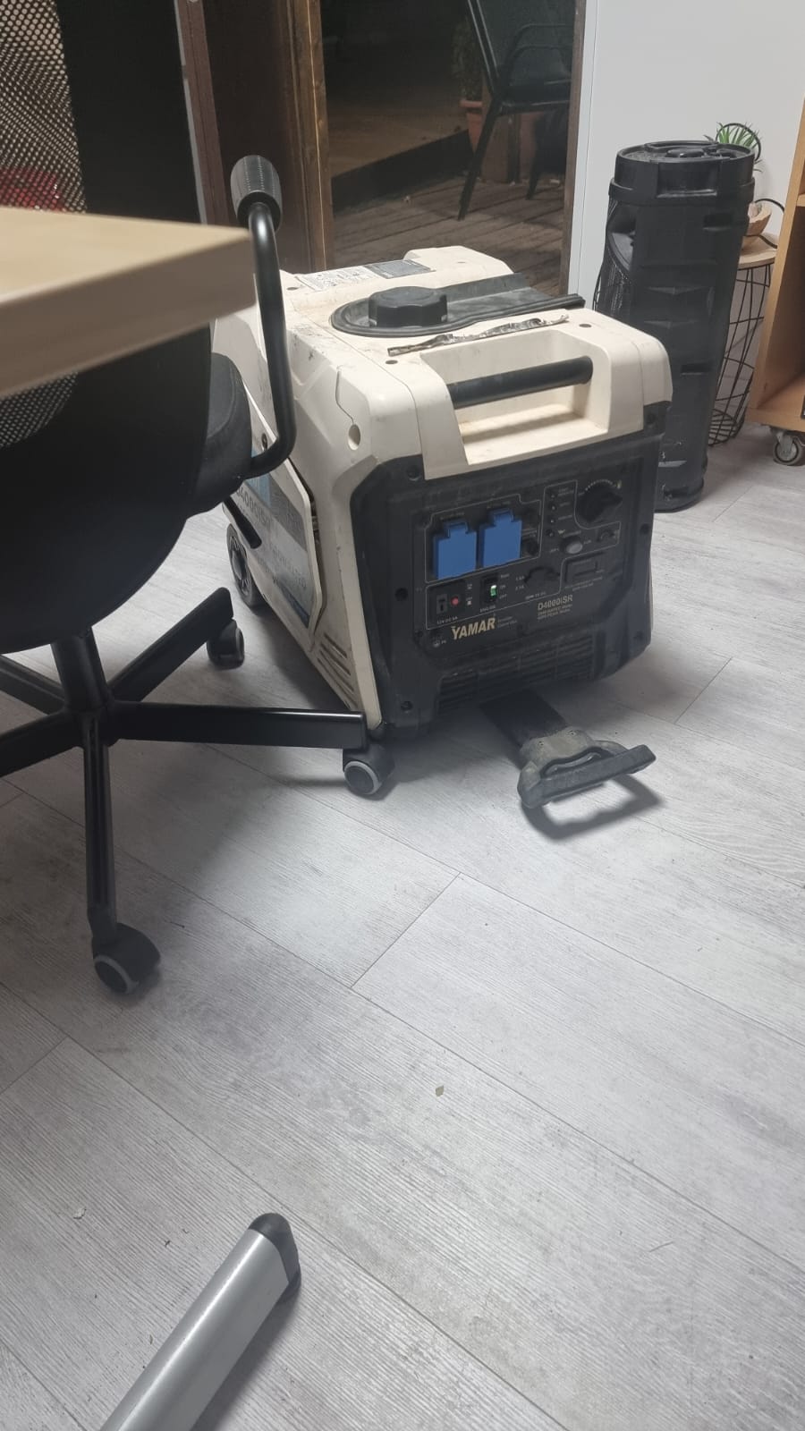

I was able to create a recording of the remote for the generator, it records the ignition frequency and that when I send a test it does not turn on the generator, is there a possibility that I end an on or off that will send the code several times in a row? And in the background of the recording?
.txt   karavan.txt (Size: 11.43 KB / Downloads: 721)

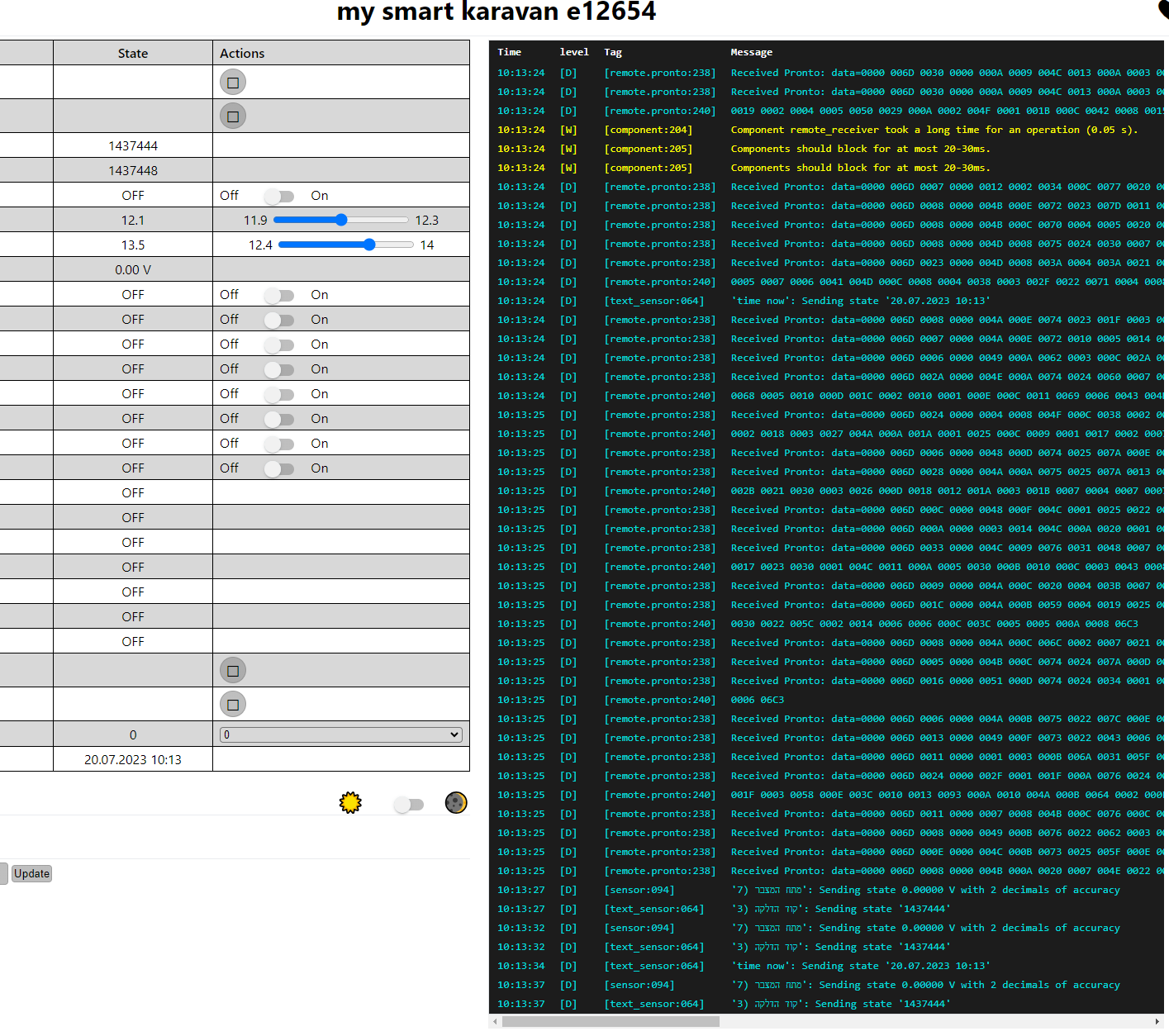

upload your log file or screen photo, when you detected RF signal. what have decode?

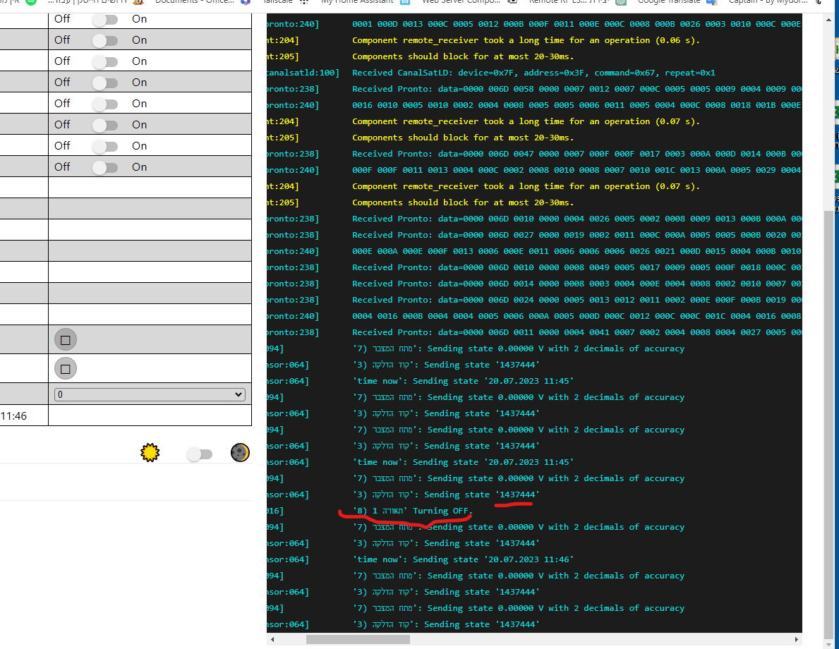

Attached is a log file of sending the ignition switch
Attached is a log file of sending the ignition switch 2
The ignition code sends a shutdown to the lighting, it is not clear why instead of sending without a breaker such as to the air conditioner

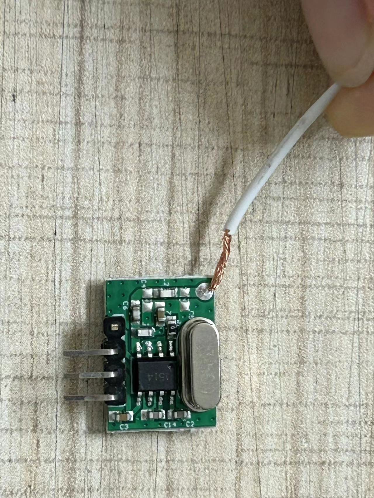

take a photo of your A8 board, whether have installed RF sender module?
I hope you now understand what I want. I need a button on the remote control for recording, a button for recording and turning off, and two test buttons for turning off and on, as in this code you prepared for me. KCS_KC868_A8_V2.0.2 I don't want to turn on RF lighting
i think you need solder an wire as antena on your RF sender module. if can't work, on weekend, i have free time, make a video tour for you, how to config RF sender learned signal with esphome.
