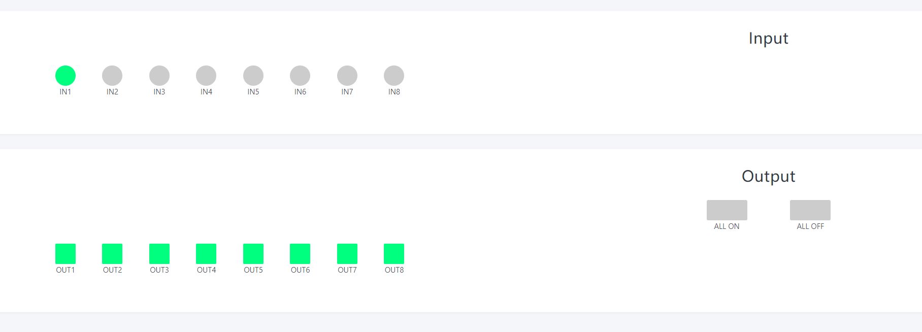

Hello.
I have new board KC868-A8M v1.1 from Aliexpress.
Firmware: KCS_KC868_A8M_V2.1.4.bin
There is no reaction to the inputs in the web interface, mqtt and others. When the outputs are turned on in the web interface, the LEDs on the board do not light up.
Not working (from first sartup) inputs and otuputs. Debug show:

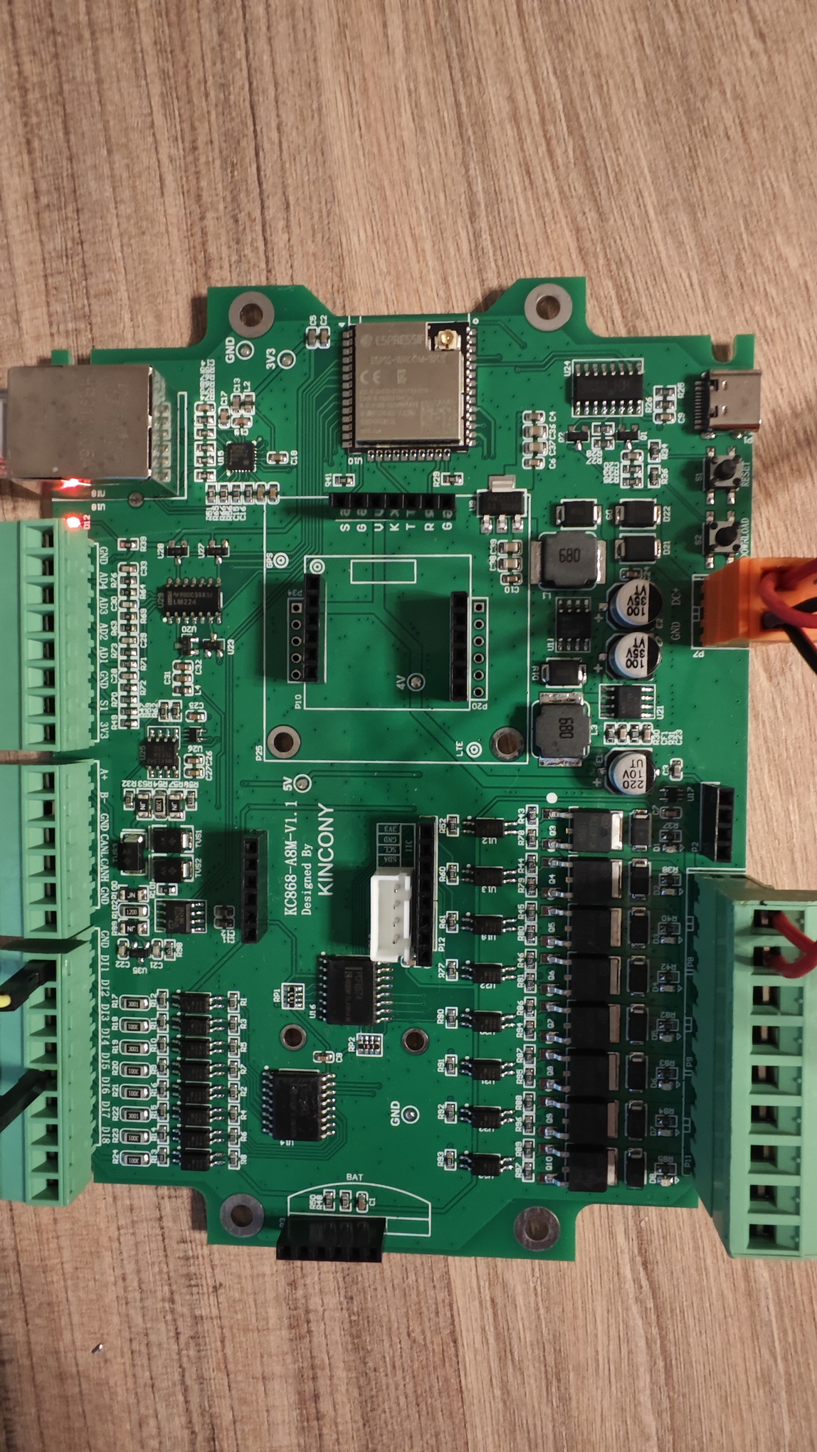

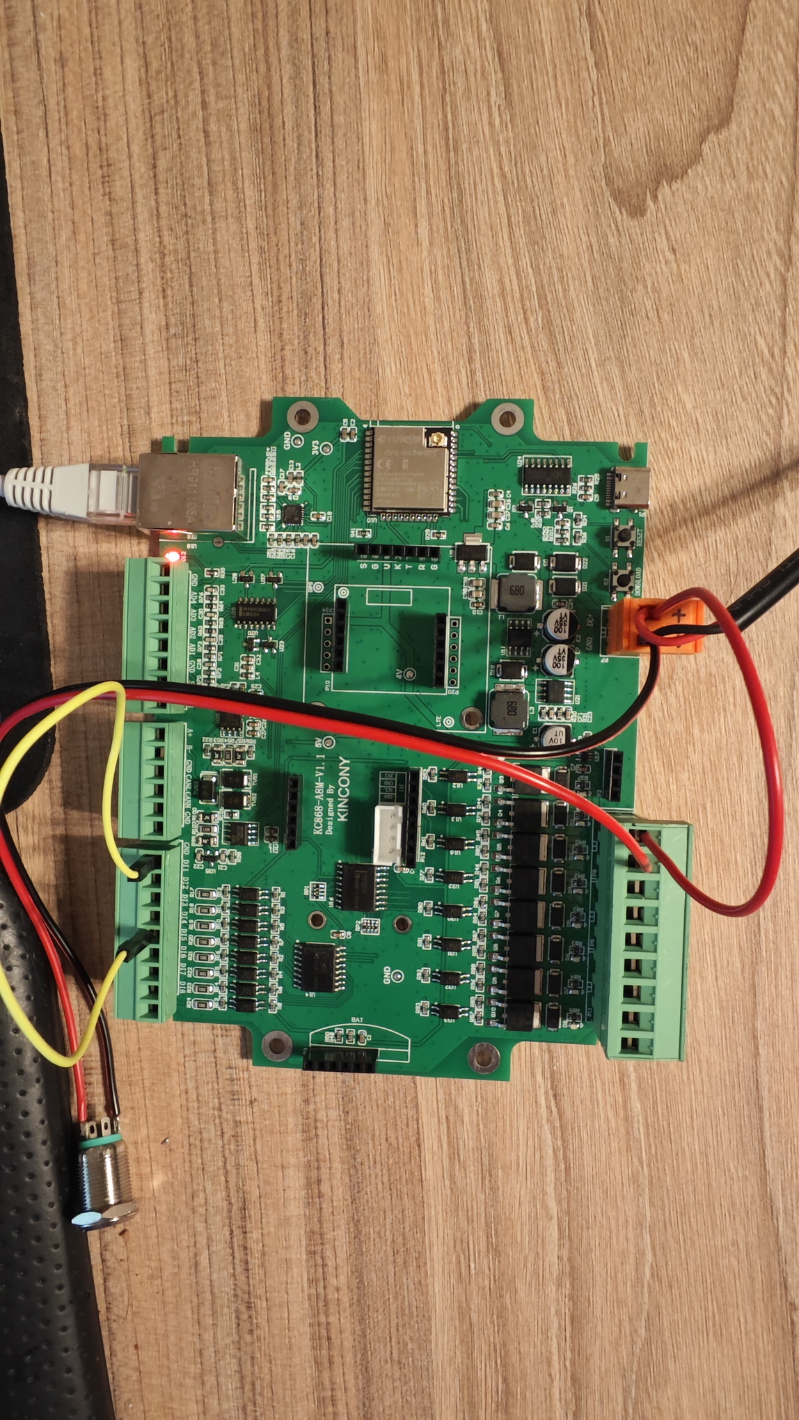

Posts: 10,617
Threads: 1,603
262
take a photo of board, i want to see how you wire.

09-18-2023, 05:07 PM
(This post was last modified: 09-18-2023, 05:39 PM by Madjo.)
The output is not triggered. By input, the values are either at the first input or at the second in random order. There is no reaction to short circuits
I also have an A16 board - it works without problems
I rechecked the Arduino code
[Arduino source code for KC868-A8M]-05 OUTPUT - the outputs are working, the LEDs are lit up. After applying 12V to the output of the transistor. It turns out that the outputs and inputs do not work only on the KCS firmware. An error in the KCS firmware code?
