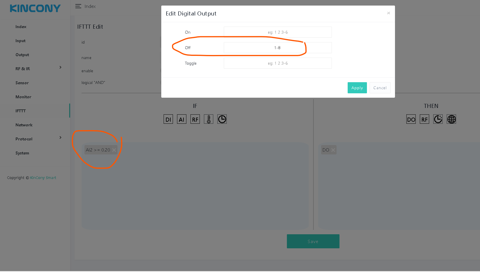

It only responds to the automation for turn on KC868-A8 relays at a certain value, but it does not respond to the automation to turn off the A8 relays when the tank is filled.

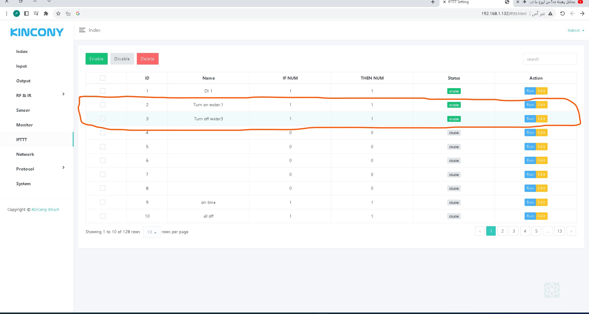

take a photo of your IFTTT command.
you need to create two IFTTT command, both been enabled.
(09-19-2023, 10:17 PM)admin Wrote: take a photo of your IFTTT command.

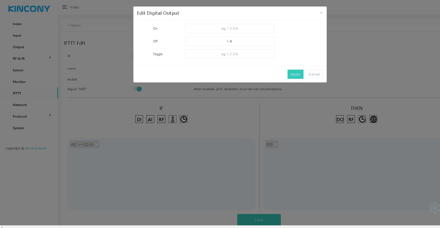

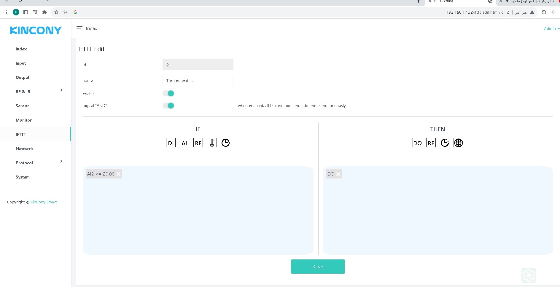

you should disable option "and"

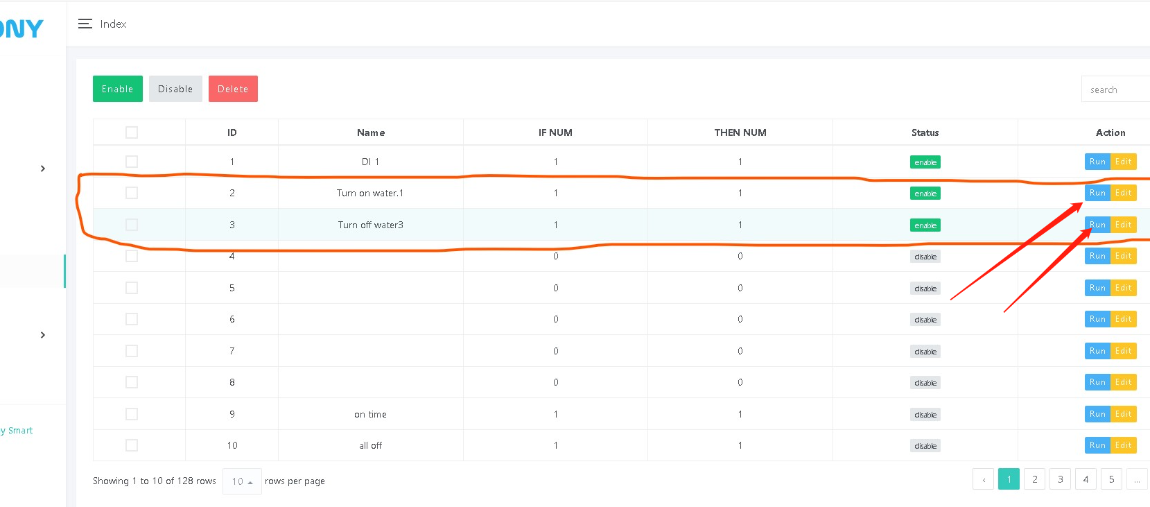

Click run to test the settings
