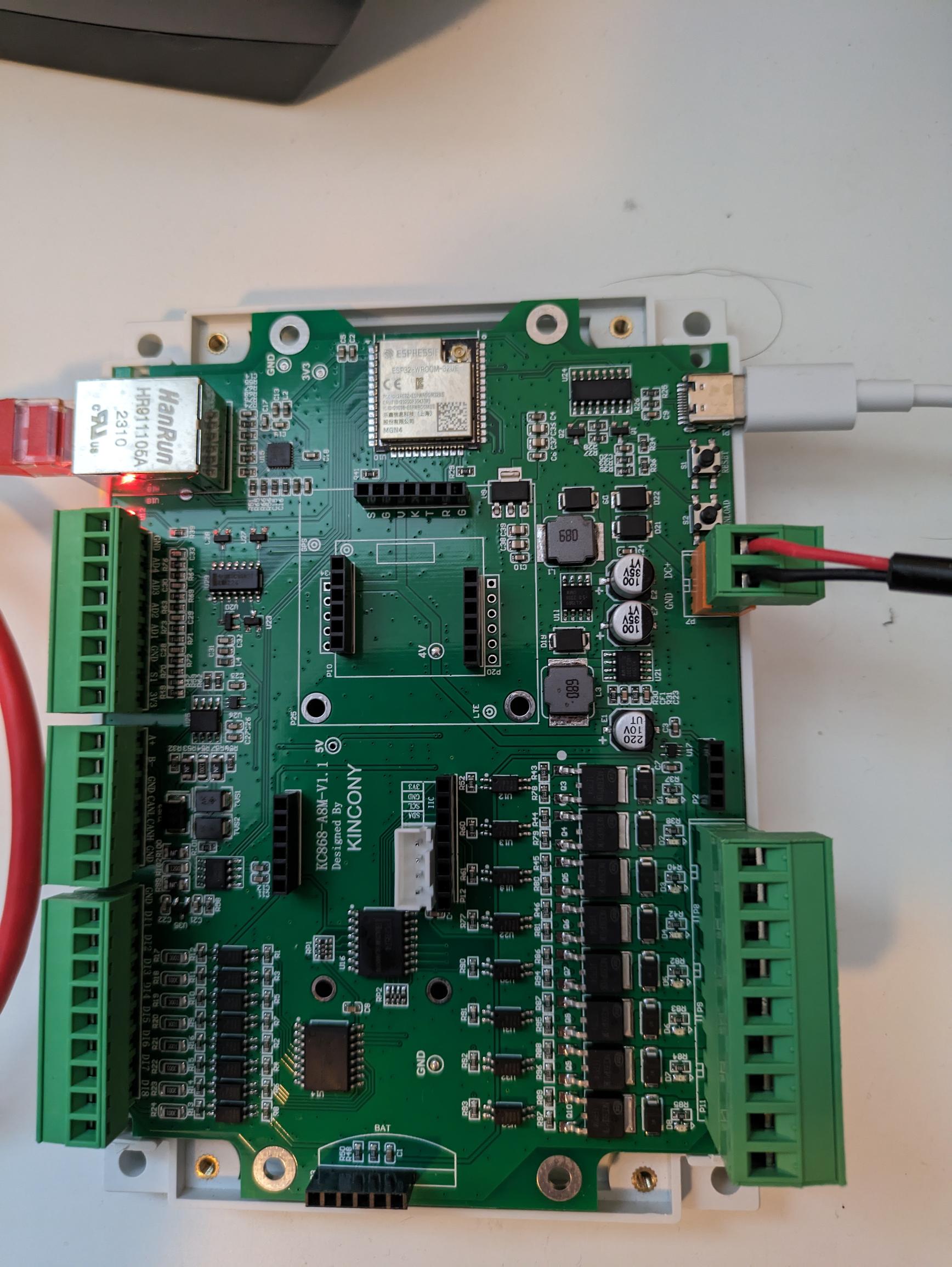

you have not connect with dc12v power supply??
(09-15-2023, 08:11 AM)admin Wrote: you have not connect with dc12v power supply??
Sorry - yes power is on :-)
here is pic
your esphome LOG showed, have not detected i2c bus device. i suggest you download KCS v2 firmware to test control relay whether work well firstly.
