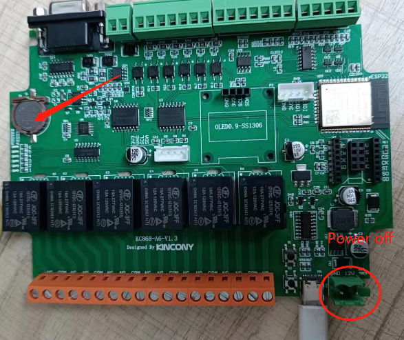

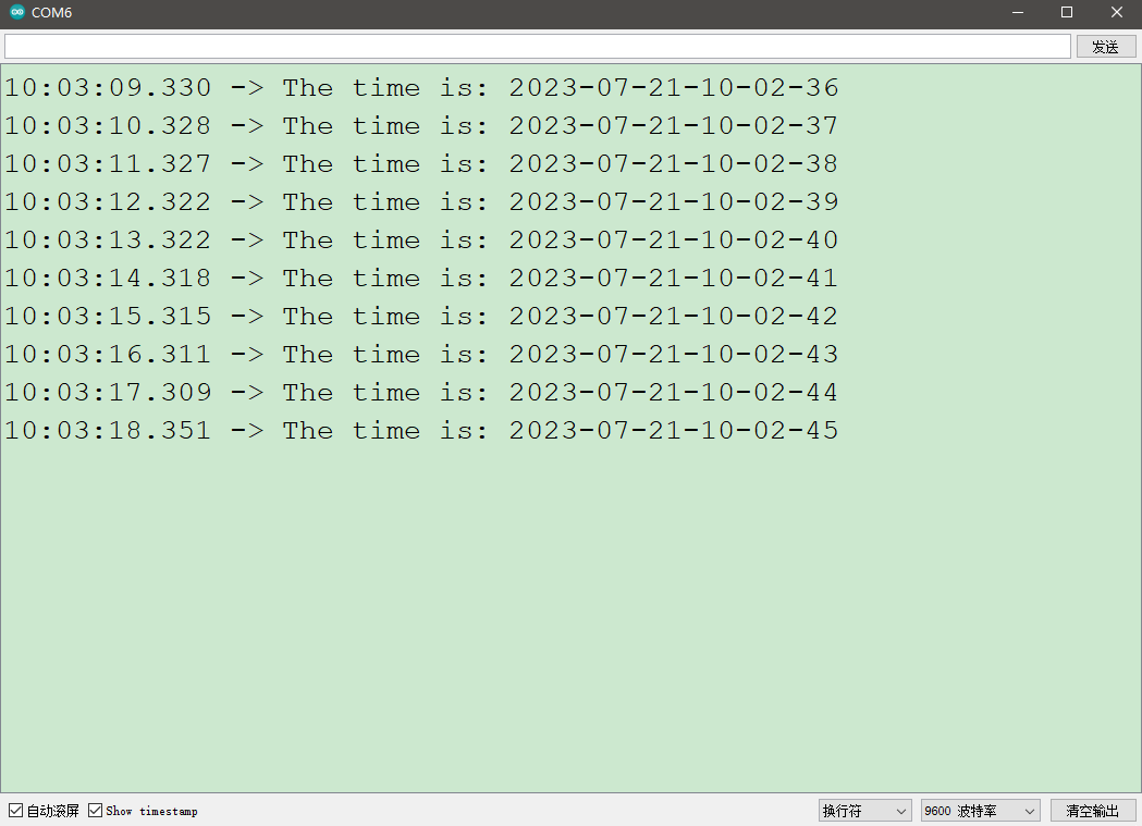

1.download the code the serial port print the time
2.power off and install CR1220
3.power on and read the time again(before power off the time is 10:02:45,and power on the time is 10:03:57)

what's your battery voltage now?
when you intsall or change battery, do you have turn OFF the power of board? it should turn OFF power , install battery, power on board again.
