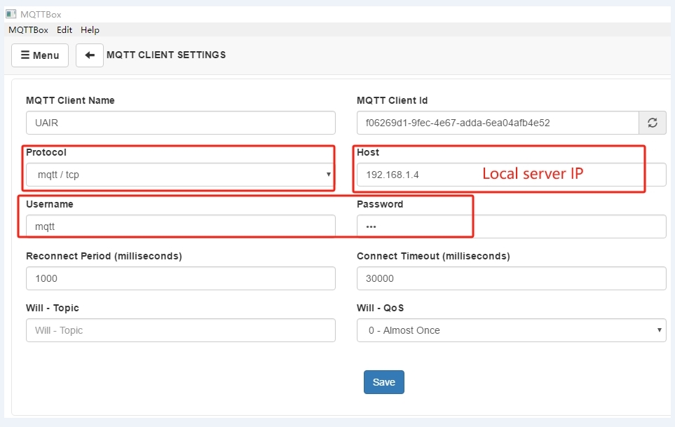

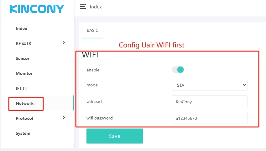

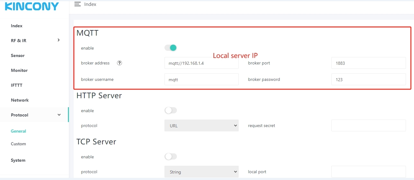

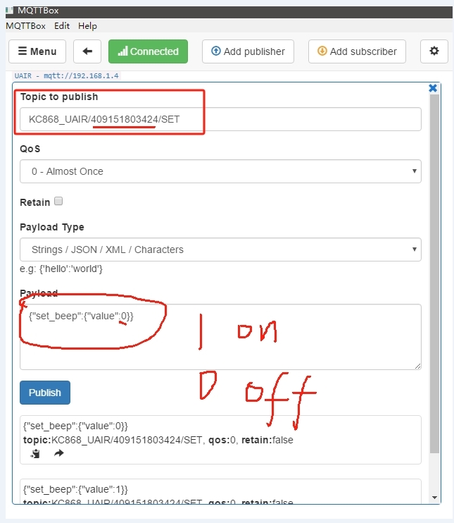

Hi,we test the MQTT,it works.you can do like this.
01: config UAIR wifi first
02: set the MQTT
03: set the MQTTBOX message
04: send the Playload message(we send the BEEP ON and OFF command)
here is the command    https://www.kincony.com/forum/attachment.php?aid=2872
mqtt protocol at here: https://www.kincony.com/forum/showthread.php?tid=3105
this showed how to send learned "IR" and "RF" signal by MQTT.
