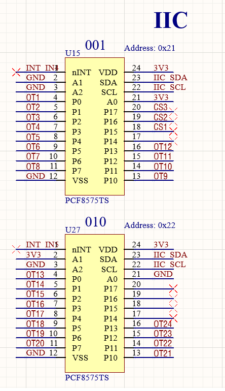

A24 arduino demo source code-01-relay output
#include "Arduino.h"
#include "PCF8575.h"
// Set i2c address
PCF8575 pcf8575_R1(0x21,16,5);
PCF8575 pcf8575_R2(0x22,16,5);

A24 arduino demo source code-01-relay output - by KinCony Support - 12-07-2023, 01:52 AM
