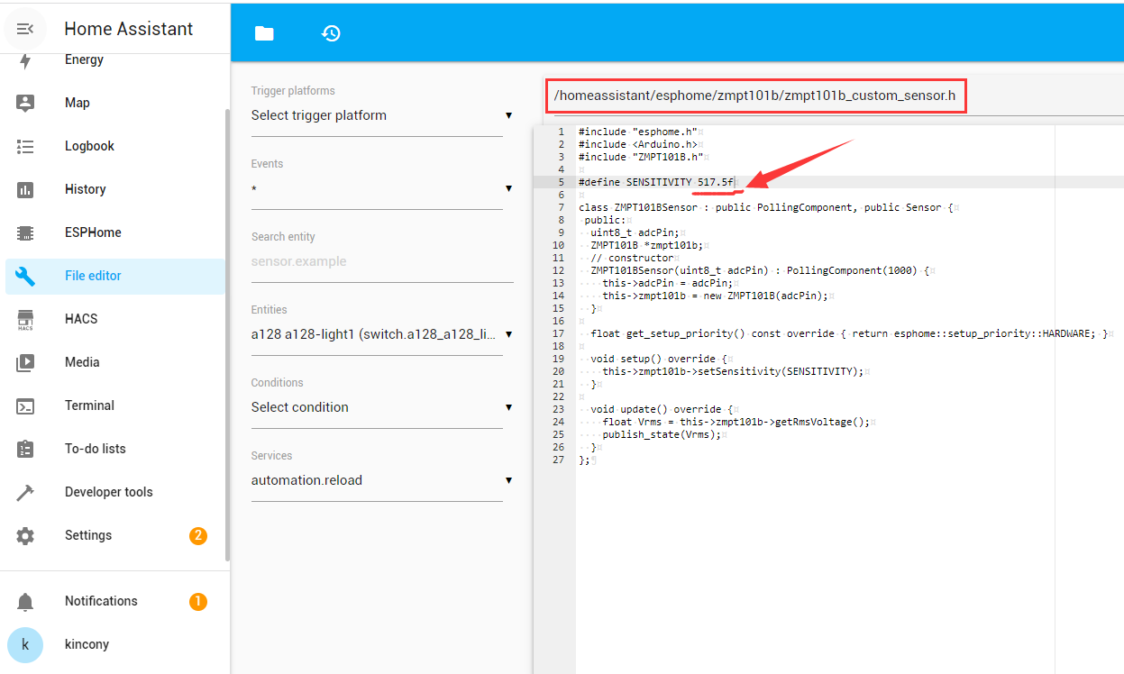

then change  "Sensitivity" value in home assistant "/homeassistant/esphome/zmpt101b/zmpt101b_custom_sensor.h"
now it's completed.
