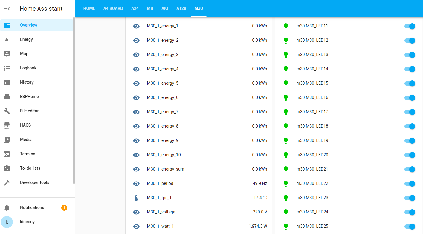

M30 configure yaml for ESPhome
yaml download:
.txt   M30_HA_LEDs.txt (Size: 49.87 KB / Downloads: 1,068)
modbus pull screen setting:
