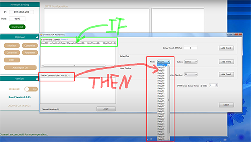

6- We also purchased a second KC868-H32B reference PLC from Kincony which we connected to our KC868-COLB PLC with a serial cable provided. (photo is atached to our previous message)
However we do not know how we configure the KC868-H32B PLC to communicate with the KC868-COLB PLC from the Kincony SBC application?
If the Kincony SBC application is not the right application suitable for the dialogue between the 2 PLCs, can you please indicate the correct application and send us the tutorial video link to configure it?
The KC868-H32B and KC868-COLB are connected through a serial cable. The then command can be set in Kincony_SCB software to turn relays on or off. this is the video  https://youtu.be/CUGD5YWwfoE
at 3:29 it will show you to set the then commands to control the Relays.
